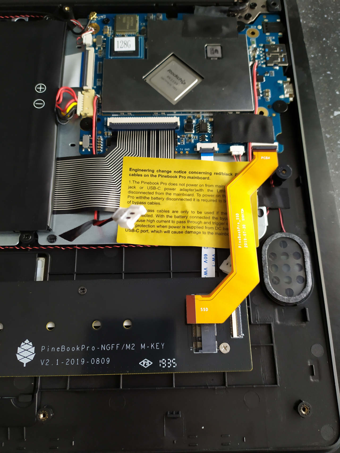

Yep..
.jpg   IMG_20191103_103753_Scaled.jpg (Size: 248.52 KB / Downloads: 747)

TWIMC:
Took off 3 cm of the adapter;
    I use a small Toshiba OCZ RC100 M.2 2242 (42 mm) NVMe SSD, 240 GB.
attached the adapter with 1 screw and a piece of double sided self-adhesive tape;
    to fit the cable.
It leaves the touchpad alone, is recognized and works now as rootfs.
