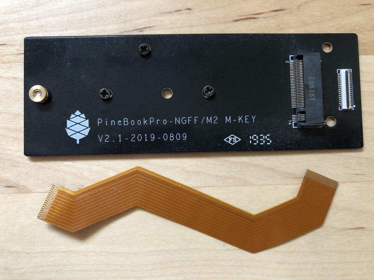

Hi Tophneal,
Is the adaptor in this image the old or new design? When I previously tried to fit it the board the ribbon didn't align with the ZIF connectors, and the board overlapped the trackpad sensor.
.jpg   photo_2020-05-14_09-13-42.jpg (Size: 192.44 KB / Downloads: 545)
(05-14-2020, 02:13 AM)Feakster Wrote: Hi Tophneal,
Yes, that's the new board. From what i understand, the board will overlap the trackpad still, but that wasn't the initial cause of the trackpad interference issue. The too tall retaining clip making contact with the touchpad was the problem (thus why those using 2280 drives had the issue, while 2242 and 2230 users do not.) Concerning the cable not lining up, my guess is that the wrong cable was grabbed when packing your order. I would advise contact support about getting the correct one.
