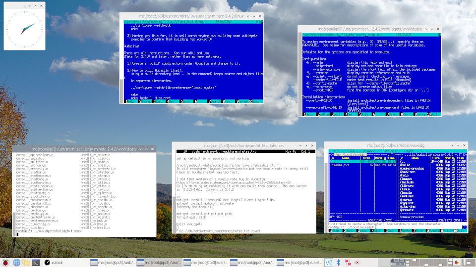

Yes but the problem is everywhere, not just in Xfree86.  It was one of my apprehensions before buying, putting that much resolution in that small an area.  I spend most of my time in rxvt and joe and mc where font sizes are measured in pixels like 6x10 or 9x15, not how many points (1/72 inches) they take up on the screen.  I have an alias that starts rxvt at the largest font size.  And sometimes it's fun in an odd way to not be in GUI mode at all but with my normal reading glasses it's a challenge just to log in.
[Image: attachment.php?aid=2080]
I was sort of hoping someone would chime in and say sure, you can change the resolution in extlinux.conf, or no, it won't work and save me the experiment.  I don't remember if the Rock64 and PBP are at all the same there.
