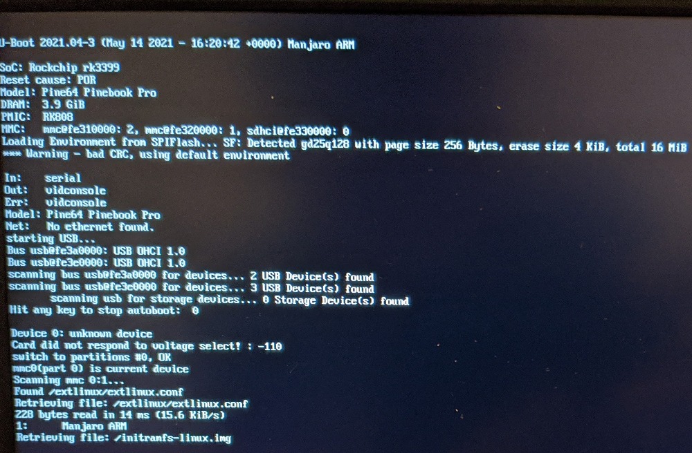

I am ready to accept that there may be a problem with my emmc.
At first, I was convinced it must be something else, because my uboot and intitramfs load. I thought my uboot was doing something wrong.
However the latest uboot, gives an error definition for the error 110 that I have been getting.
emmc not responding to voltage select.
If you look at the output of this uboot, you will see that regardless of the error, it still finds initramfs.
After that finishes, if I click the arrowkeys on the manjaro boot menu I get hit with error 110 4 times and that's the end.
Clearly there is some kind of problem that doesn't matter if it does happen to boot.

Pictures of uboot and post uboot attached.

I'm sorry to hear that. It might be worth trying to open up the laptop and reseat the eMMC module, while inspecting if everything is OK with the connectors on the eMMC module and on the main board.  There's slight chance it will help, but at least you can say the Pine64 support you've tried everything.

I have reseated it many times since I got it a little over a week ago, and inspected the sockets with a microscope. I didn't see anything obviously wrong. Thanks for the link.
(05-17-2021, 10:08 PM)djhnsn Wrote: I have reseated it many times since I got it a little over a week ago, and inspected the sockets with a microscope. I didn't see anything obviously wrong. Thanks for the link.
You're welcome.  You should be able to get a replacement eMMC module, the one you received is clearly faulty.
Regarding the compatibility with eMMC modules other than those sold by Pine64, I think that a few forum members have reported succecss with some of the eMMC modules sold by Odroid, with a Samsung eMMC chip.  Unfortunately, that's all I'm aware of.
