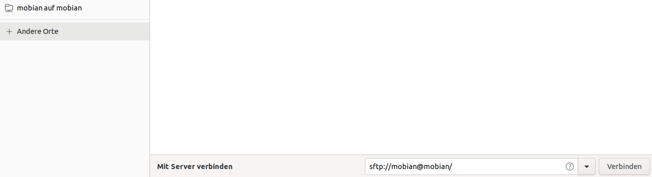

Ubuntu 20.04 => File Manager => Server adress "sftp://mobian@mobian"
Password: 1234
HTH
Ciao
Walter

Walter's sftp method would be good, except for me it just keeps prompting for the password, even though I'm entering the right one. All very frustrating. (I use debian/kde and dolphin file manager. It may not handle sftp as elegantly as ubuntu.)
