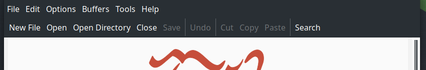

I am not messaging from my new pinebook pro right now. I just wanted to give you more details about the problem:
After deciding to use the default Manjaro KDE in the flash drive; I installed emacs from the pacman. Trying to launch the program didn't work for me; after a bit of googling I figured out emacs doesn't like inconsistencies in theme settings between the kde look and feel and that of gtk/gnome. I set the gtk settings to breeze and I am able to start emacs now.
However, the toolbar of emacs is lacking any icons: neither breeze nor adwaita icons. Fortunately, all the toolbar icons are still there with text only. So, it is still usable. I am not sure at this stage if this is intentionally tweaked by Manjaro/Pine developers. In any case I am not happy with this because I tend to use emacs toolbar at the side of the emacs buffer to gain screen estate. Text only icons occupy too much space esp. on the side.
I will try your suggestions and update if it fixes anything. If it doesn't fix, I will compile emacs from sources to see if it fixes anything. Emacs is a very important program for me and I want it to be working as bug free as possible. I may consider switching to Xfce or maybe debian (though mate desktop is not my favorite environment) if I feel further problems with Manjaro kde.

Hi there,
Attached is the screenshot of emacs menubar+toolbar.
.png   Screenshot_20200806_185625.png (Size: 20.42 KB / Downloads: 670)
