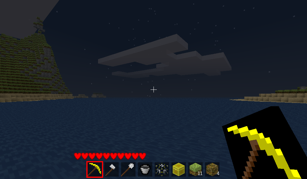

[100%] Built target minetest
real    9m23.876s
user    50m19.589s
sys     1m48.254s
PBP on wall power, still stock MrFixit OS (glad to hear kernel 5.x is rock stable, this one is 99.9% stable), nothing else running but the desktop environment.
Runs fine too. Pretty.
[Image: attachment.php?aid=1852]

If your workflow involves building sizeable software packages, it's useful to know at least order-of-magnitude how fast a platform will do it. Something like Firefox takes incredibly long to build on hardware that's still usable for other purposes. And it isn't easy to deduce from the spec.
.png   minetest.png (Size: 172.69 KB / Downloads: 1,486)
