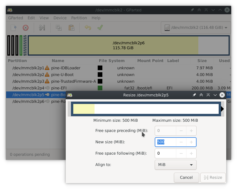

What's up with gparted?
It never renders right, eventually crashing the graphical session - X11 and Wayland.
Works fine for me on KDE Plasma:
[Image: attachment.php?aid=1622]
About mesa updates, etc. - if you install packages from experimental AFAIK you'd need to pin experimental archive to priority 100 to ensure APT will be installing updates from it, as by default its priority is set to 1 and will install packages from there only when explicitly asked. In my case I didn't get any mesa updates (that were upgraded in experimental from 20.0-git to 20.0-rc1) until I pinned experimental to 100. If you don't know what APT pinning is read `man apt_preferences`.
.png   Screenshot_20200206_064219.png (Size: 94.66 KB / Downloads: 1,296)
(02-06-2020, 08:44 AM)moonwalkers Wrote: Works fine for me on KDE Plasma:
Are you using zram? I think that this is also an issue. gparted seems to dislike these block devices it creates in RAM. May be a separate issue, tho'.
$ sudo zramctl NAME       ALGORITHM DISKSIZE   DATA COMPR  TOTAL STREAMS MOUNTPOINT /dev/zram0 lzo-rle       7.6G 346.6M 94.6M 100.8M       6 [SWAP] $ free -h              total        used        free      shared  buff/cache   available Mem:          3.8Gi       1.7Gi       431Mi       325Mi       1.7Gi       1.7Gi Swap:         7.5Gi       347Mi       7.2Gi
