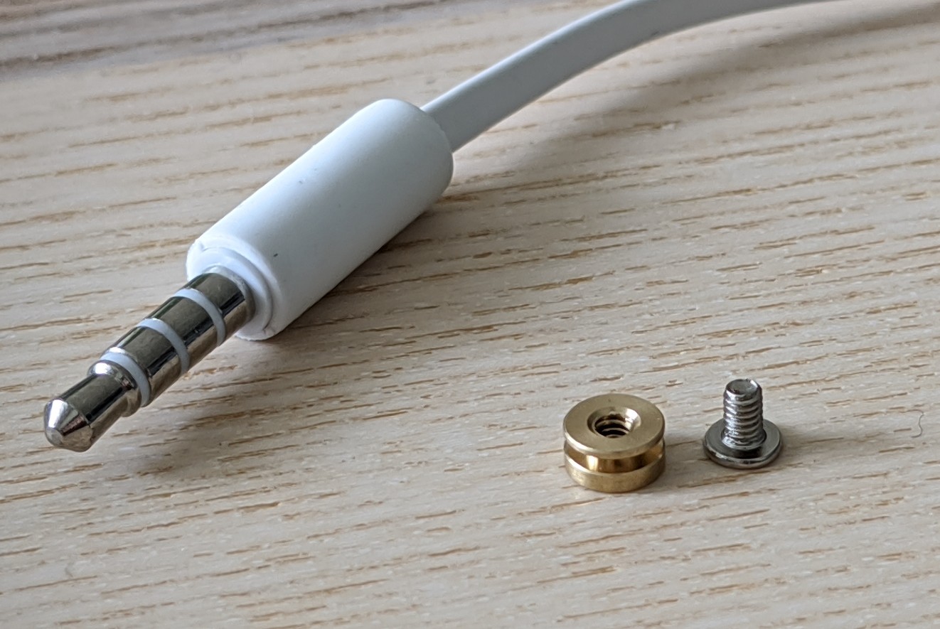

- For testing I've stuck the drive onto the board breakout board with some tesa 61395 tape, and there's no impediment with that.

However, this causes a problem.  Namely, none of the mounting holes line up at all, which means the SSD is kinda just free-floating inside the case.  To remedy that, I drilled a hole in the nvme PCB (7/64" [imperial units, sorry] I believe) and taped over it.  You can see this here and here.  This seems to have worked "well enough".  It's not perfect, but it's taking most of the tension off of the cable.
