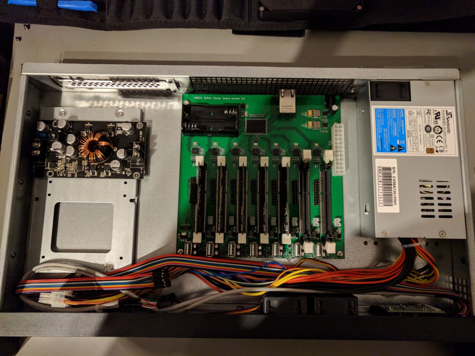

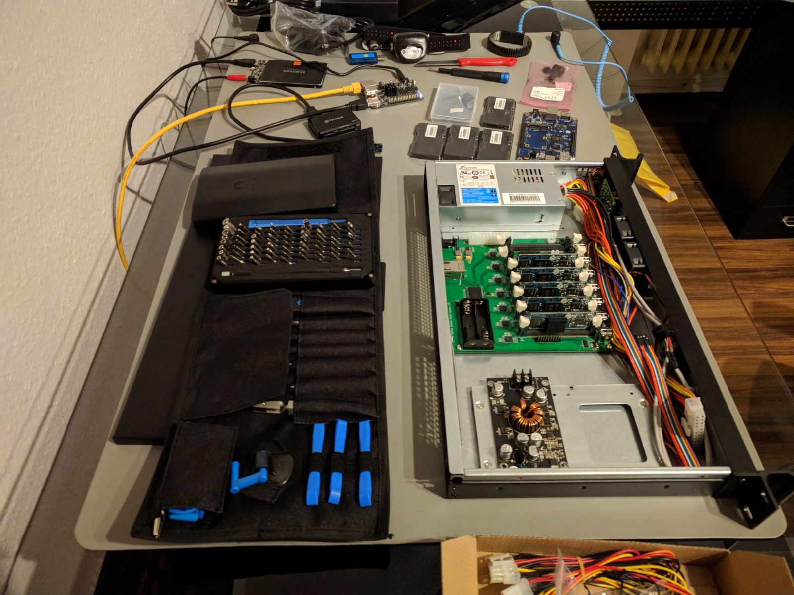

Thanks to Tl Lim, my clusterboard prototype for SOPine64 modules arrived a couple of days ago and I started to set it up in an old ITX rack mount case. I will try and post some more thoughts and results during the initial bring up and testing.
The board itself is of mini-ITX formfactor and provides slots for 7 SOPine64 modules networked by the onboard GbE switch. Some interfaces of each module are exposed on the board like two USB ports and a header with UART, SPI, I2C and things like RESET, PWR_ON...

My current plan to power the board (5V input only, so maybe 15-20A max) is to use the normal FlexATX PSU I used in the case. The Seasonic SS250-SU is a 250W ATX12V 2.3 unit that provides 17A@5V, 22A@12V and 14A@3,3V. Since the topology of those ATX PSU's doesnt allow for low/no load operation each rail has to be loaded with a minimum load specified in the datasheet. For the SS250-SU this is 3.3V - zero load, 5V - 0.5A, 12V-2A. To not waste the 24W on the 12V I will probably use the DC/DC converter in the pictures and go from 12V to 5V for efficiency reasons...
Next step will probably be to completetly rewire the ATX power cable, fans and front panel connectors with some veroboard to get some controls in and add some features like thermal management, power sequencing and safety... the front panel probably also needs some kind of status display...

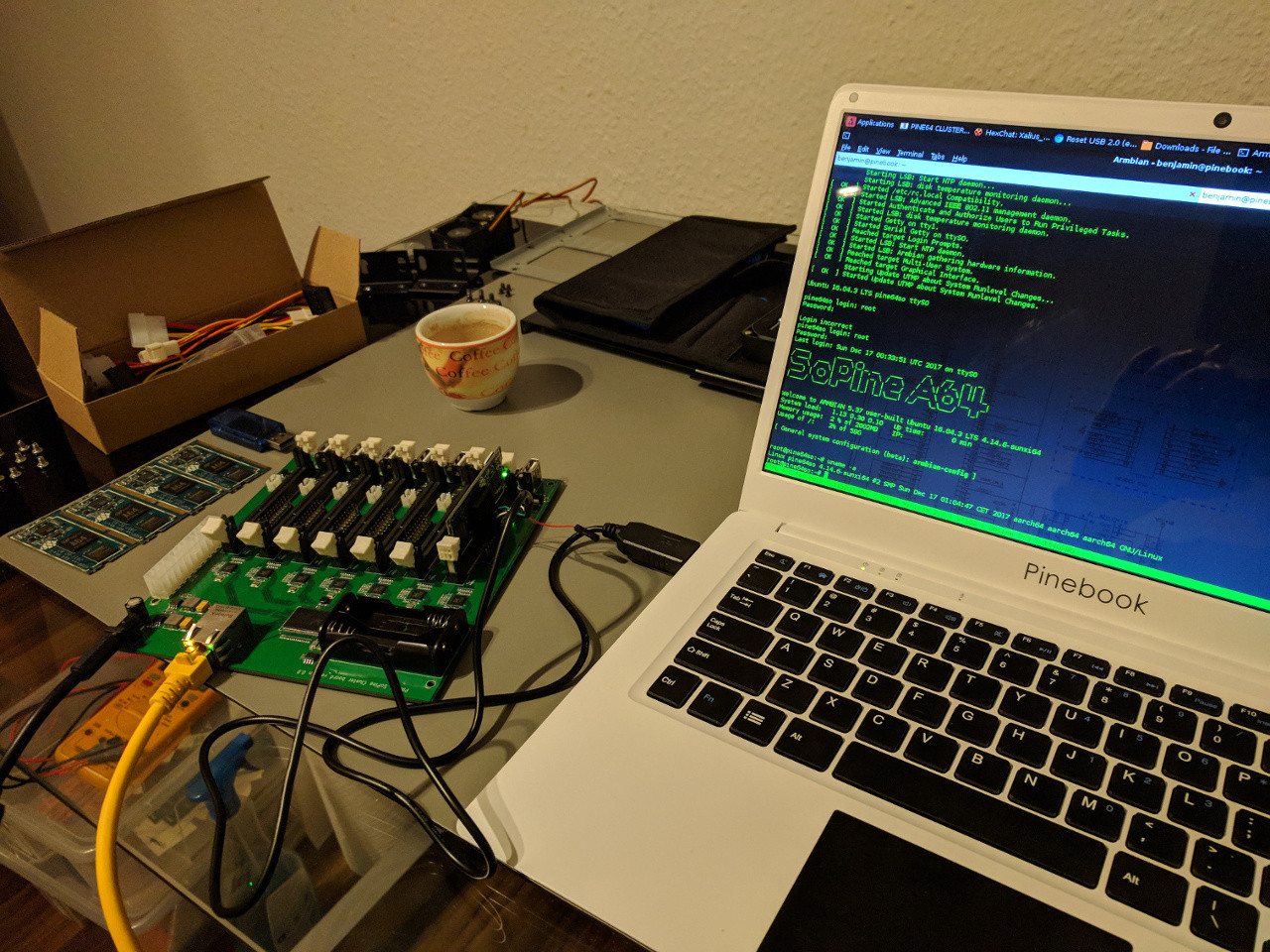

I built an Armbian mainline image for a first quick test that boots from sdcard, which seems to work fine, but GbE does not seem to  work stable yet, after some changes to the dts I at least got a link... I then tried with ayufan's last xenial-minimal image (legacy kernel) and that worked fine out of the box...
first boot...
two nodes...
I ran some quick iperf3 tests between the nodes and to an external box and got between 800-900Mbit/s , so network hardware seems to be OK... next step is to fix the mainline image as I don't really want to work with legacy kernel here...

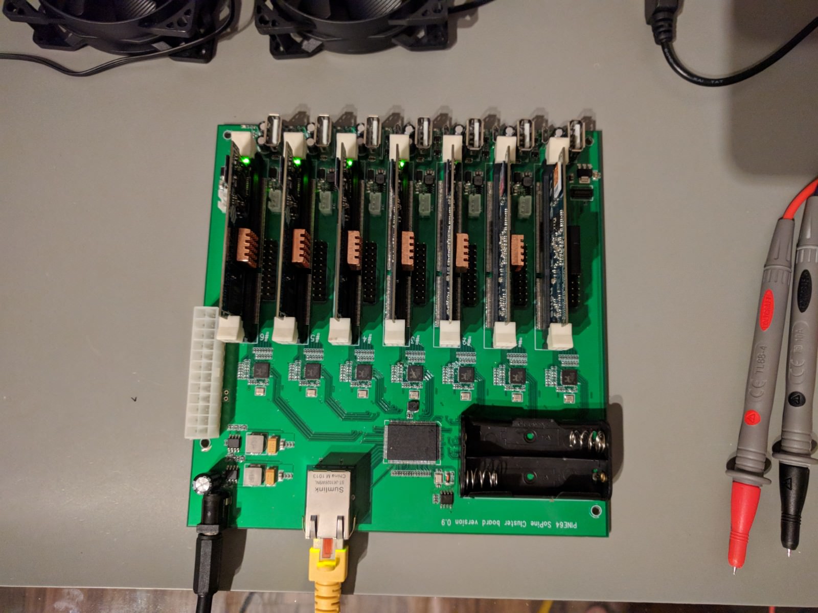

Some more parts (heatsinks, sdcards for local storage, fans,....) arrived and I set up the rest of the modules, so we have a fully populated board now...

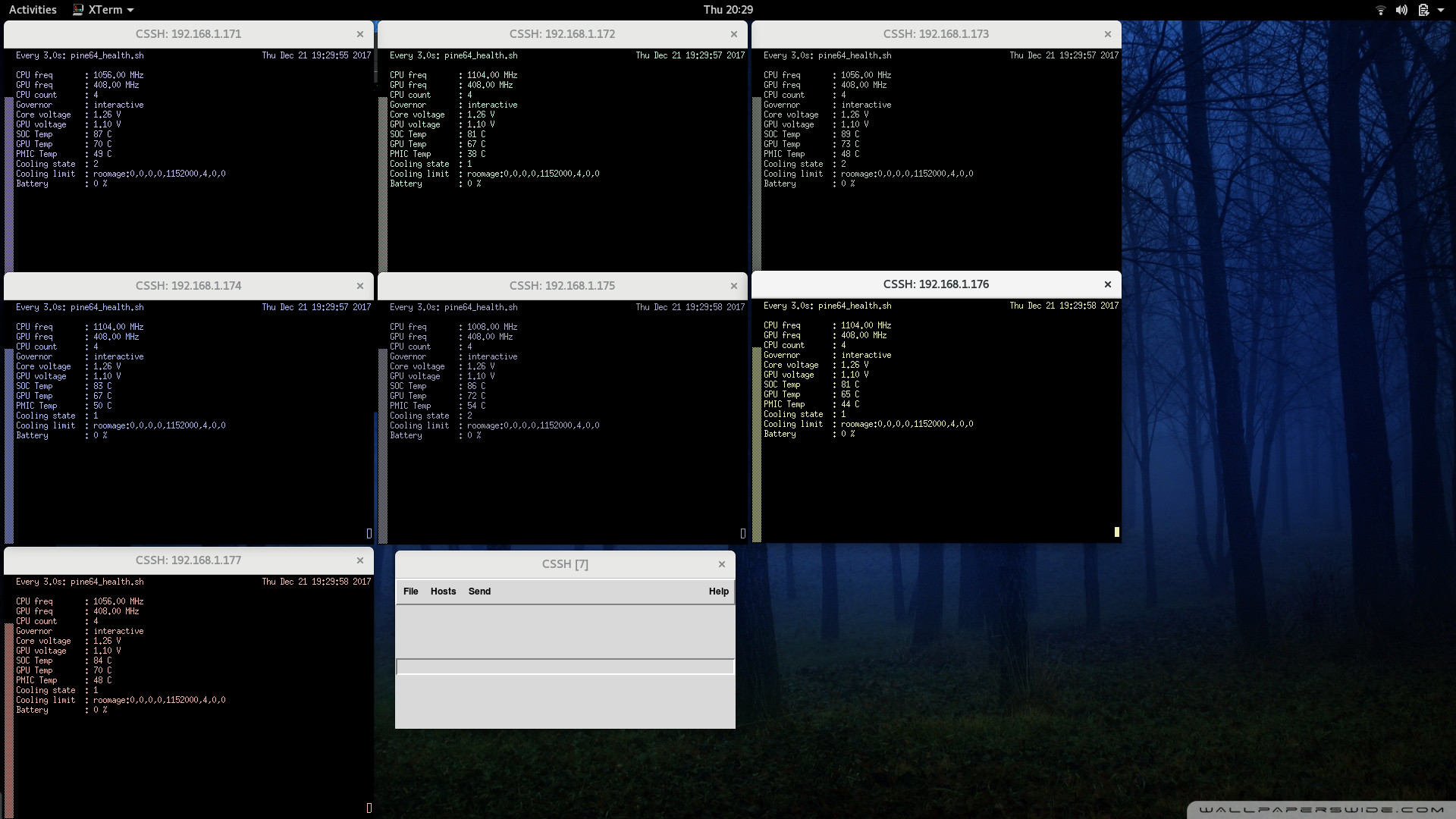

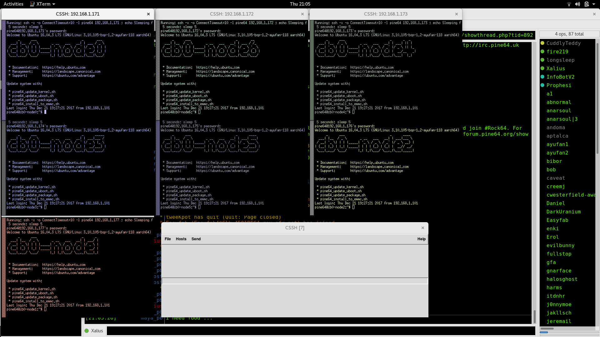

Running all 7 nodes with simple test images seems to work fine, clusterssh helps a lot with sending commands to all of them at once Smile
ClusterSSH (cssh) login...

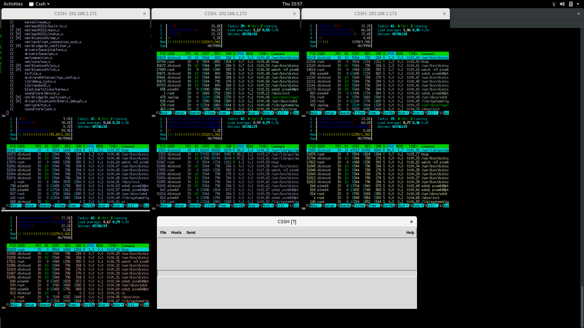

Running cpuburn-a53 on all nodes/cores...

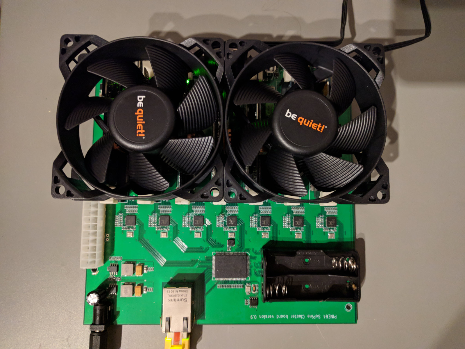

While running cpuburn-a53 on all nodes to check out the stability of the system, I also added the two 80mm x 80mm fans... those are needed under full continuous load to prevent frequency throttling of the cores.
80x80mm fans with 2000RPM@12V/0.13A
I need to come up with some fan mounts and maybe some air duct or chimney...

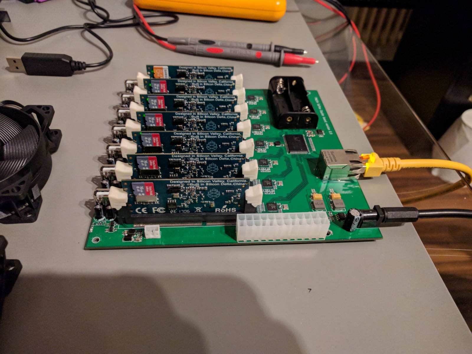

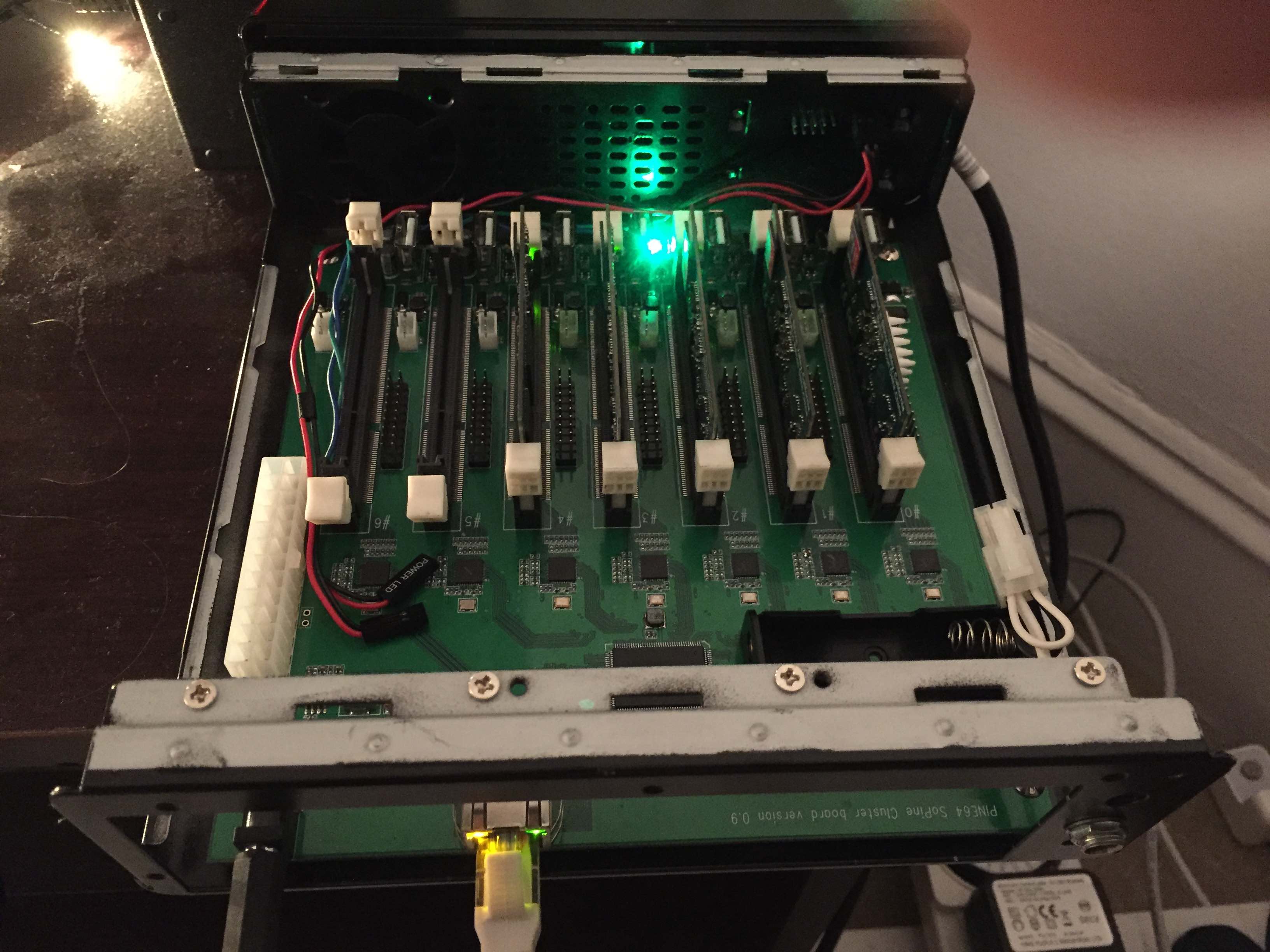

Here's the board with 5 sopines up and running - each sopine has flashing I'm alive LEDs but only one got caught in the photo.
Presenlty mounted in an m350 mini-itx case.
(12-28-2017, 01:38 PM)maya.b Wrote: Playing catchup - my cluster board only just arrived unfortunately.
Got a Kubernetes book the other day ...
You got to create a custom backplate Smile

Got a minimal Kubernetes cluster up and running Big Grin - will post details - presently it's 4 nodes (one of my sopine modules decided to melt itself Undecided )
