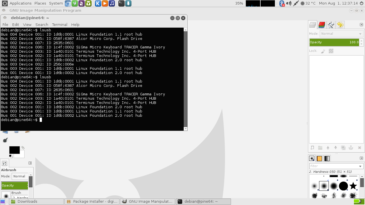

I tried to install given DEB package from Digimend on Pine64 ( Digimend GitHub ) and also to make manual install from source with SU rights. For this procedure it is needed kernel version 6 and upper as I could understand from their description how to install drivers
In both ways drivers looks like are installed properly (no error reported) but device is still not detected.
When I try to list if device it gives only ID with numbers of it:
Here is list of lsusb -v and what I get for this device:
Bus 003 Device 002: ID 256c:006e
Couldn't open device, some information will be missing
Device Descriptor:

The github page you link says "Kernel v3.5 or newer is required. Kernel headers or the build tree for the running kernel are required." We have all this in place with the Ubuntu or Debian images (Kernel 3.10.102+ and headers). So if you follow the manual build instructions to get a package for arm64, where does it fail?
[attachment=394 Wrote:xalius pid='17069' dateline='1470049833']The github page you link says "Kernel v3.5 or newer is required. Kernel headers or the build tree for the running kernel are required." We have all this in place with the Ubuntu or Debian images (Kernel 3.10.102+ and headers). So if you follow the manual build instructions to get a package for arm64, where does it fail?
It fails at place where it is not working at all. it is not detected by GIMP or system as working input device. It says that it is there, but without any additional info just numbers in lsusb output (Bus 003 on first listing on attached picture).
