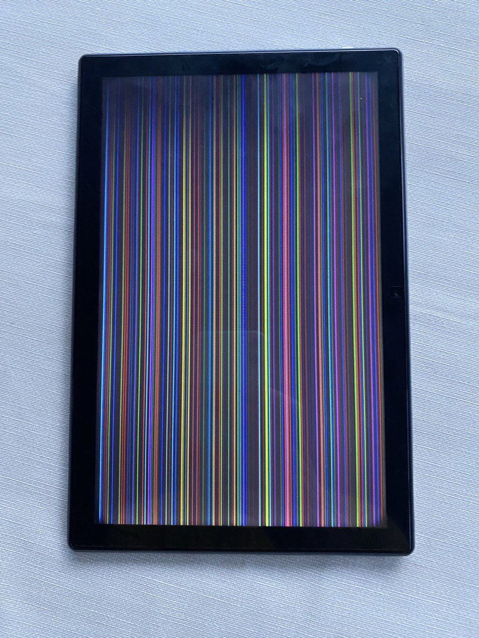

Hi all,
after a month using my pinetab2 the screen started flickering one day then i got a screen with colored vertical thin lines (image attached), and now it does not start at all.
I did not do any software upgrade during the weeks previous to this happening and i'm running the installation that came with the device.
I tried to plug the UART to the lower usb-c and followed the instructions here:
https://wiki.pine64.org/wiki/PineTab2#Co...RT_adapter
To see if i could see something but it looks like the device does not even start, i also tried to reset it (using the press 7 seconds, 3 second wait, 3-4 seconds press) several times but nothing happens, also left it charging overnight without any result.
From the outside i do not see any light or anything else, just the green light on the UART when it's plugged via USB to the computer.
Anyone can give me advice on what to do next? i'm a bit lost now.
Thanks!

Try to reseat the LCD ribbon cable and check whether help.

Thanks for your answer, however if it was the cable, then i should see something connecting the UART right?
Is there any way i can open a "support ticket" for this?
