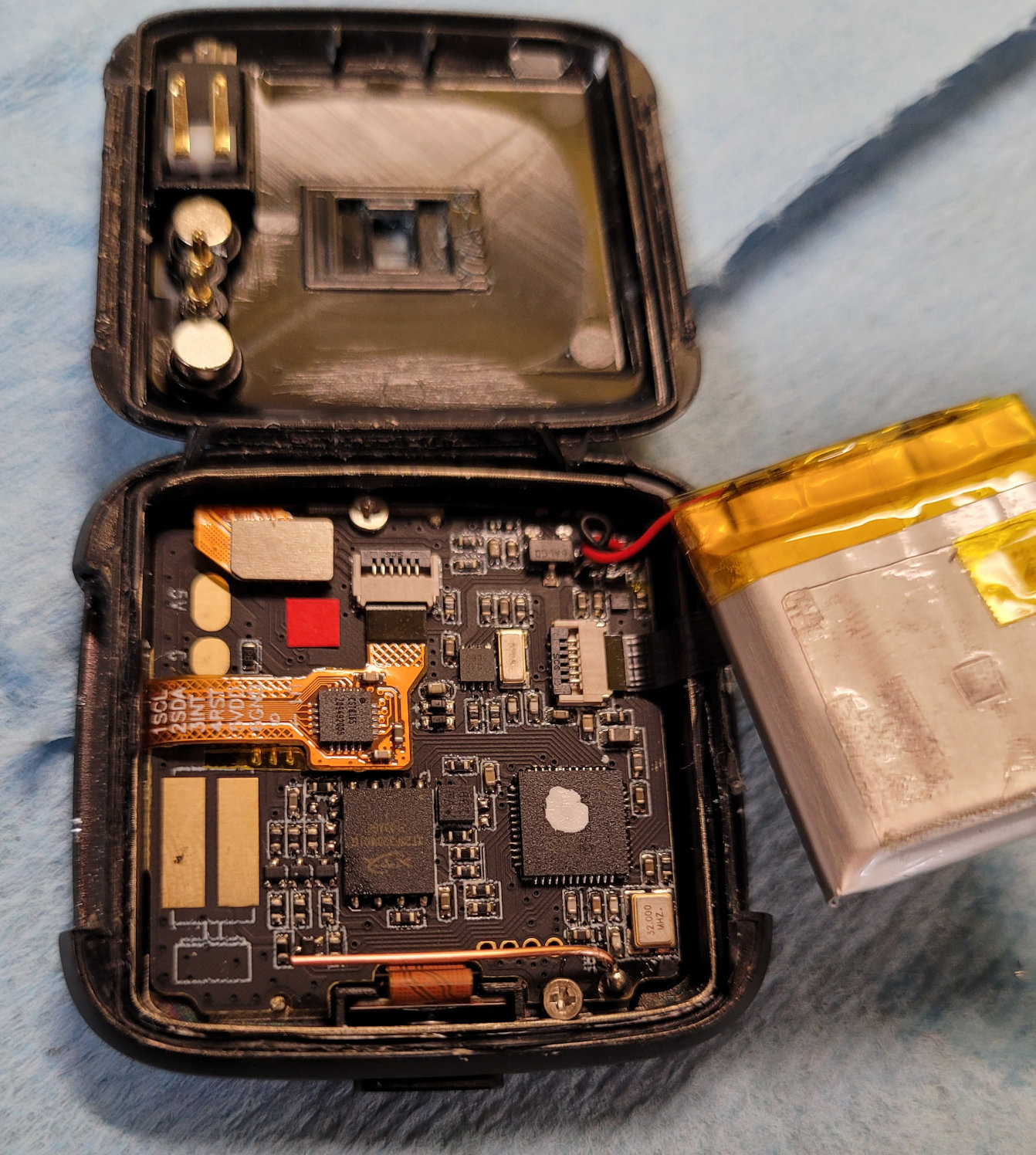

Update:
I managed to open my Pinetime following the instructions in the post I linked in my previous reply.
I'm now thinking it might be due to water damage because of the green residue (probably copper oxide) visible in the blue circle on the attached picture. I'm baffled since exposure of my watch to water was limited.
Most of the internals looked ok though.
Cleaned up the green residue and tried reconnecting the screen anyway. I was able to get better image quality but still missing the right edge of the display. Guess screen LCD might be damaged.
@wibble and @barray  thanks for your help  Smile
Couldn't resist and ordered another Pinetime!!! (at least I'll have spare parts)

(09-13-2022, 09:14 PM)Spater Wrote: Still, I'm wondering if the Pinetime is really waterproof as stated on pine64 website "The PineTime comes with a IP67 rating, meaning that it can handle up to one meter of water"
Okay... It looks as if the water come through the HR sensor. I wonder if this is actually sealed? From memory it just pops out, but my watch was never a sealed unit.
The heart rate sensor window is clear plastic, stuck to the back cover. Depending on how well I align it when I put the back cover on it sometimes looks like there's some pressure on the back, raising the middle of the window slightly. It's seem most easily if you view at an angle to see the distortion of the reflection on the window. I could imagine this leading to a leak over time. Since I stuck the back on myself I've assumed it will leak, but between sweat and rain it's been ok so far.
