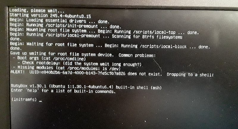

I tried this release and it worked GREAT on the SD card! So I decided to flash it to the eMMC. It flashed fine but failed to boot. I disabled the splash image so I could see what was happening - see attached. It couldn't find the boot device, even though it's there. I'm currently using tow-boot flashed to SPI (also works great). I know it gets to the eMMC (I changed the armbianEnv.txt file to point to /dev/mmcblk2p1 and it complained about that too, so I know it's reading the /boot directory     ).
I used dd to flash the device, and the contents look fine. Same dd command I used for the SD card I've been testing with.
The UUID it says it can't find is the correct one set for the partition. And even though it says it's dropping to the shell, I can't type anything (no, I don't have a serial UART cable). Don't know anything about hardware  initialization process. Anyone have any idea where to look?

(03-03-2022, 07:47 PM)rleasle Wrote: So I decided to flash it to the eMMC. It flashed fine but failed to boot. I disabled the splash image so I could see what was happening - see attached. It couldn't find the boot device, even though it's there. I'm currently using tow-boot flashed to SPI (also works great). I know it gets to the eMMC (I changed the armbianEnv.txt file to point to /dev/mmcblk2p1 and it complained about that too, so I know it's reading the /boot directory).
I am not so sure about using tow-boot in concert with Armbian. The canonical way (in Armbian) would have been to use the nand-sata-install tool[0], either directly, or from armbian-config, in order to install to eMMC from sd card. As this process may (often does) differ between hardware.
But now, with tow-boot on SPI, this may complicate things.
[0] An unfortunate historical name which has now stuck, but it does flash to many different media, including eMMC.
Thanks for the reply. Tried using Armbian's install script as suggested. Same error. I even tried erasing the SPI, but apparently there wasn't a usable u-boot on the eMMC, so now I can't boot anything - I'll have to open up the machine and disable the eMMC ...
