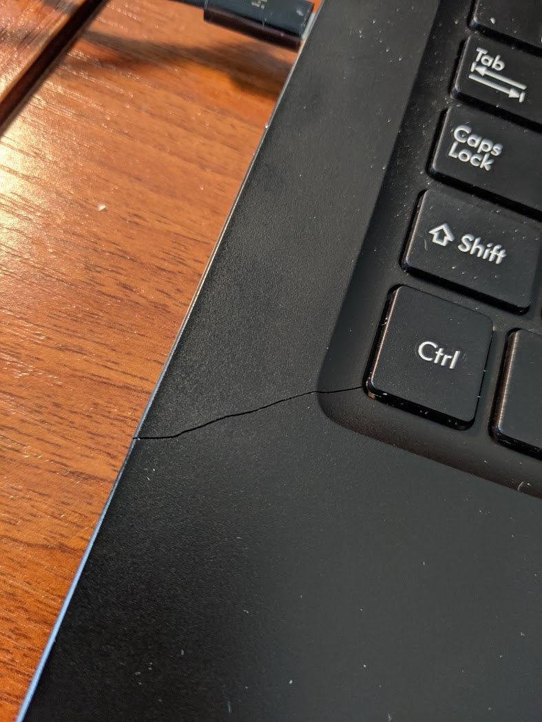

It wasn't through the website; I contacted their sales team directly via email to ask if I could buy a replacement, and they obliged. It was US$30, plus shipping, for both halves of the lower case together. That included a keyboard and trackpad. I assume it's not ready for mass ordering yet, since it's not on the store page. I got the impression that they happened to have one in stock because more cases have been manufactured so far than mainboards. If it's just the keyboard layout that's a problem, you can set the keyboard layout to ANSI in software and get a very ANSI-like experience; main exception being backslash's new home next to the quote key.
I didn't ask them for any sort of replacement-under-warranty because my crack was definitely my fault. The corner screws near the hinge are, in fact, extremely critical to the structural integrity of the hinge. (The wiki's stern warning is, if anything, not stern enough.) By leaving one out, I put tremendous stress on that part of the case every time I moved the lid.
Disassembly and installation wasn't too difficult, but wasn't simple either: disconnect and unscrew until there's nothing left attached to the case, then do everything in reverse. Not for the faint of heart, but if you have a keen eye, a steady hand, and a small Philips screwdriver, you have what you need to do it.
This is my case crack, at the bottom sides of display

Add me to the list of cracked PBPs.  Mine cracked with relatively little stress.

(03-14-2020, 01:01 AM)Solra Bizna Wrote: It wasn't through the website; I contacted their sales team directly via email to ask if I could buy a replacement, and they obliged. It was US$30, plus shipping, for both halves of the lower case together. That included a keyboard and trackpad. I assume it's not ready for mass ordering yet, since it's not on the store page. I got the impression that they happened to have one in stock because more cases have been manufactured so far than mainboards. If it's just the keyboard layout that's a problem, you can set the keyboard layout to ANSI in software and get a very ANSI-like experience; main exception being backslash's new home next to the quote key.

I felt the hinges were to tight and getting more tight. Until the hinges started to make a cracking noise.
I have put a small drop of oil (I use for skeelers) on the metal part you can see in the hinge.
It prevents the hinge from breaking; the Pinebookpro is closing smoothly and makes no more noise.
What type/brand of oil did you use exactly? My Pinebook Pro seems to be having a similar problem. Thanks!
From a small plastic bottle, it only states "silicone oil", nothing else. Years ago came with the skeelers.
It needs a few days to penetrate.

hi, I own number #39 128G easily model may be the first dispatch.  The plastic creaks and moans every time I use this laptop.  Actual physical cracks exist seen over the last 5 months or so. Cracks exist on all four counters of the screen perimeter bezels.  I did, however, fix most of the creak issues by taking off the bottom cover for eMMC maintenance e.g. reflash via USB adapter.  Snugged the screws up a little more and now the sounds mostly disappear.  I will try silicone lube next to see if all is good.

Perhaps a drop of oil on the hinges may re-leave some of the stress seen on other parts of the PBP....?
but then hopefully the hinges will not get too loose and the screen flop around ?
