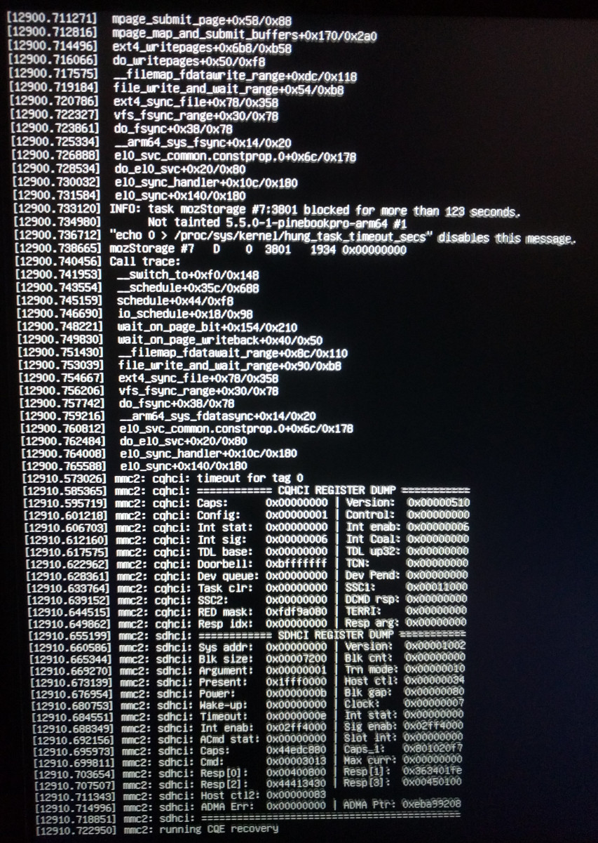

Once, when on battery, the system even "lost" the eMMS it was running from. See the attached photograph for the kernel messages from that crash:
.jpg   emmc_loss_pbp.jpg (Size: 399.74 KB / Downloads: 998)
Is anyone else here having similar issues? Any suggestions as to what I could do (apart from keeping the power adapter with me, or a backup system on sd card)? Maybe getting an NVMe and running a system from that would help?
