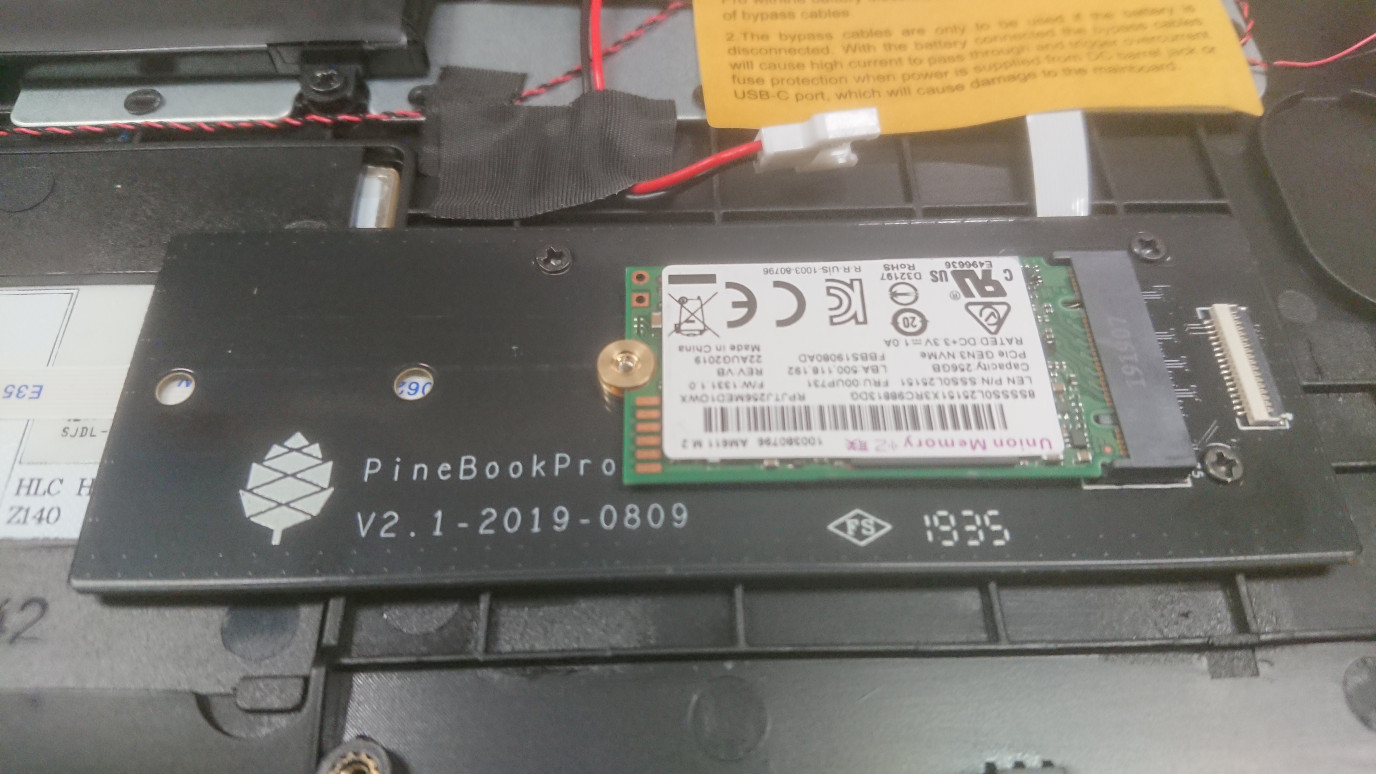

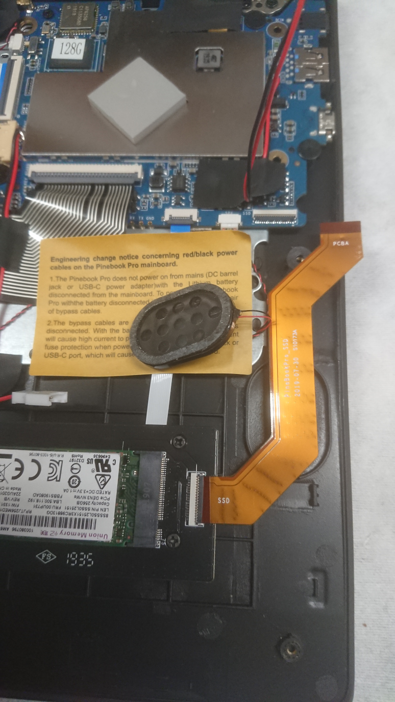

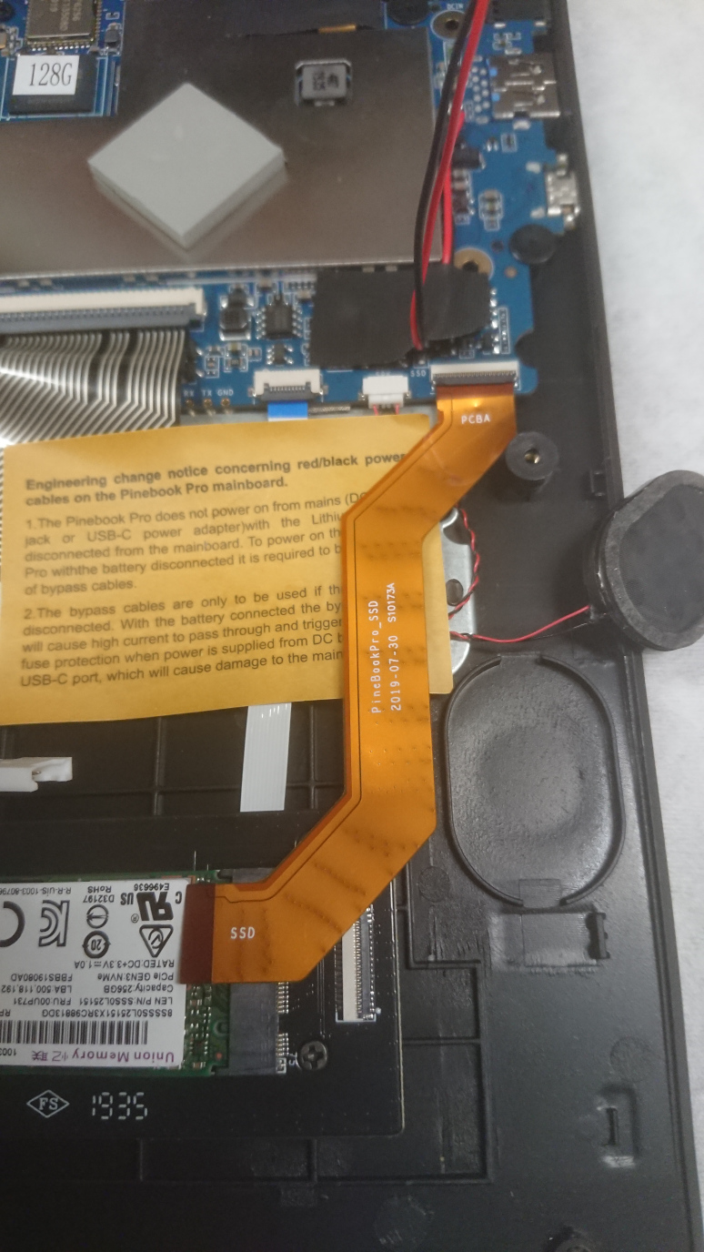

Hi all
I've taken some photos from the NVMe adapter
The PCB itself fits, only the cable have some slighly issue
