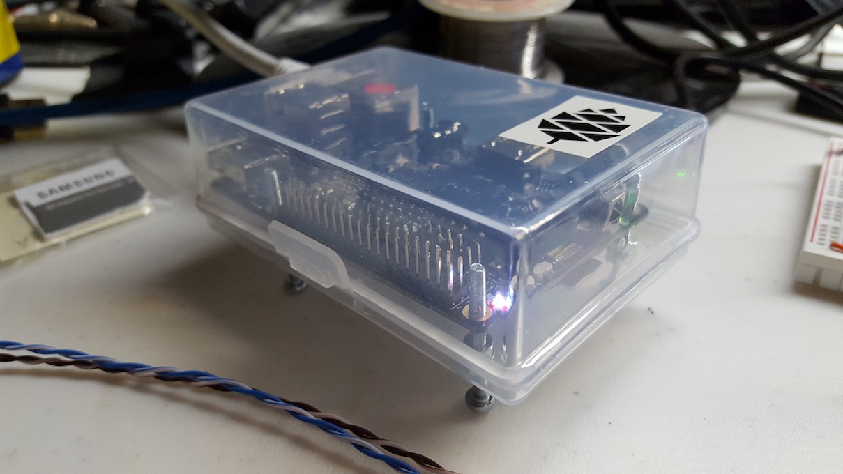

  ROCK64 Acrylic Enclosure Assembly
Posted by: ironhand - 08-26-2017, 02:17 PM - Forum: Rock64 Hardware and Accessories - Replies (2)
Has anyone installed his ROCK64 in the 'ROCK64 ACRYLIC OPEN ENCLOSURE'?  There don't appear to be any assembly instructions....  From the product photo, it looks like the board is supposed to be pressed onto the toothed brass standoffs that are included with the enclosure hardware but the mounting holes on the board would have to be opened-up a bit in order to be pressed on to the standoffs and not damage the board.  I don't want to open up the holes if there's something I'm missing regarding the assembly...
Thanks!
Ron
