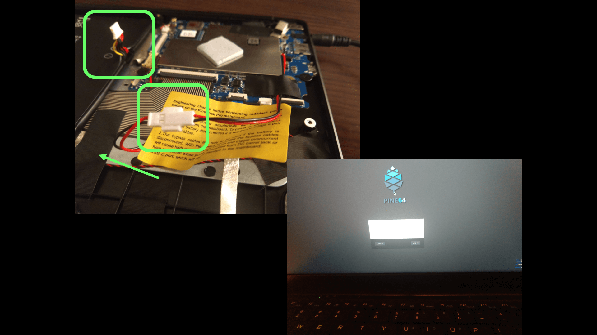

UPDATE - NOW POWERED UP VIA MAINS! Re: PBP No Power
*****UPDATED 2/15/20*****
I was able to troubleshoot and ascertain that my PBP has a defective battery pack.
I disabled the battery pack by unplugging its bus connector (and eventually removed it once finished testing).
I was able to easily boot to mains with the AC adapter, after connecting it to the power bus that is under the black tape
(note the attachment of a photo I took to show the troubleshooting).
What is the best replacement spec for this battery pack, either from Pine or alternative source based on this one evidently being defective?  Angel
Thanks!

.png   Mains.png (Size: 326.35 KB / Downloads: 672)

Hi - I was able to locate Support on the Store and have been in touch regarding my battery pack issue.
If anyone else needs to go this route here is the link to start a service ticket:
https://support.pine64.org/portal/home
