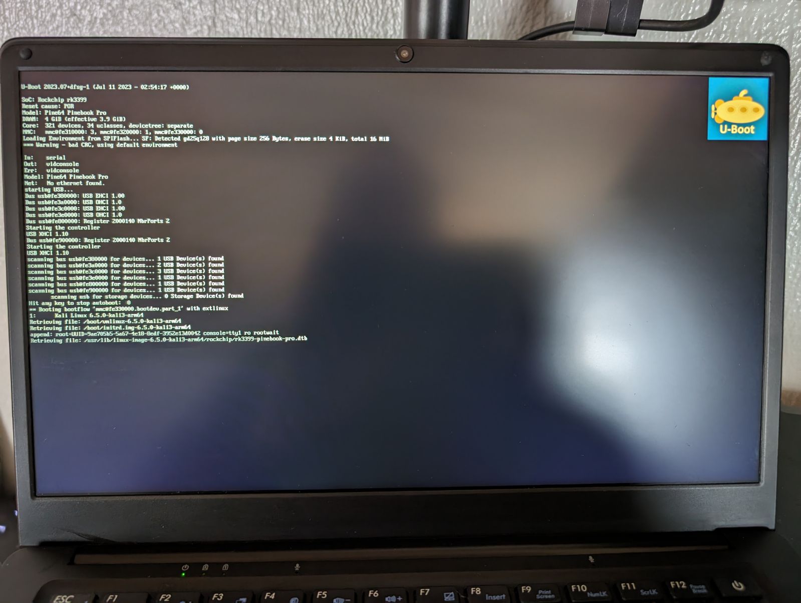

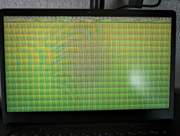

can someone tell me how to revert to an older version of U-Boot or upgrade to a working version?  I am currently running version 2023.07+dfsg-1.  It will no longer boot from an SD card.   I put a screen shot with the errors then after it flashes like it is adjusting video then boots.  I does then same on reboot but get stuck at the flashing screen.
When I read this, it sounds like a cold boot works ???
Reboot has always (or nearly so) been problematic, so why not just shutdown, then restart

Yes cold boot works.   I just flashed it yesterday with the 2024 uboot in the repo.  Still getting the CRC error and won't boot off SD to reinstall os on EMMC?
With my 2022 PBP:
The Kali installer does disable the Sdcard boot by default when you install it to the eMMC & the color bars are normal for the display after the initial boot-up screen; it doesn’t affect operation.
The PBP will not reboot & when you try, it’ll get stuck on a gray/colors screen similar to the start up one. You always need to power it off instead. (Reinstalling will not change it.)

can SD be re-enabled in Kali?
The boot rom search order is fixed (spi, emmc, sd), if you have a serial terminal
you can alter uboot priority .... setenv boot_targets mmc1 ; boot
some uboots will look to sd (mmc1) first, check with.... strings u-boot.itb|grep _targets
OR install tow-boot
OR save emmc 1st 16M, save emmc mbr, blank emmc 1st 16M, restore emmc mbr, make a small sd boot card for emmc boot
Since the only uboot is on sd, that is what will boot, if the sd has no boot cfg files will then look to emmc
boot cfg files = boot.scr (or boot/boot.scr), extlinux.conf (in appropriate 2 paths), aarch64.efi
