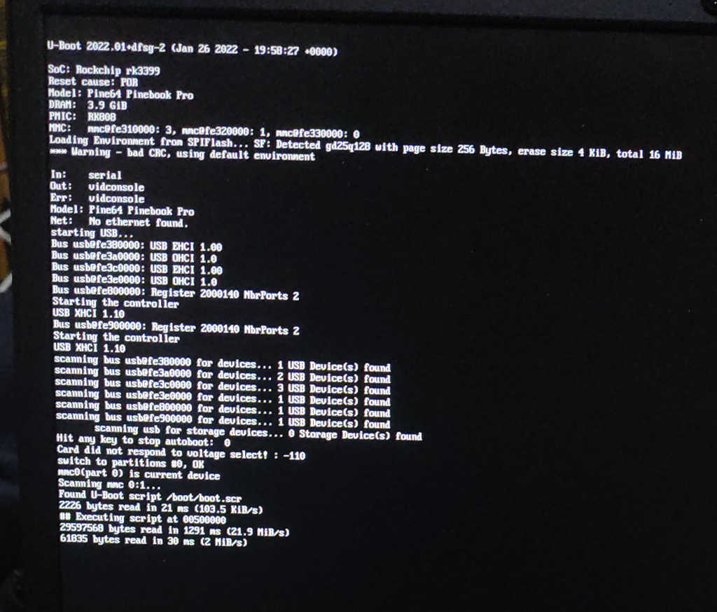

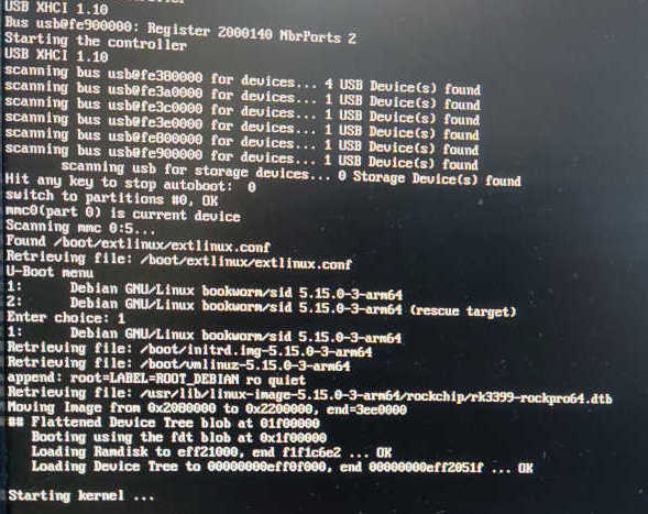

No dice I'm afraid! I did try modifying /etc/default/u-boot replacing the line in it with U_BOOT_ROOT="root=LABEL_ROOT_DEBIAN" . I've attached a picture of this btw.
I also checked with fdisk and found the emmc (while on its usb adapter) dosen't start at 32768 but 251904 so guessing that won't work.
I'll try again with just the one partiton starting at 32768.
Update: I tried again with one partiton starting at 32768 and this time it looks like things worked ok :-) . Will post back here later to show what I did (pretty much just fdisk'd on another computer starting at 32768, installed via the debian installer, chroot, ran u-boot-update /dev/sda and then tried booting off the emmc).

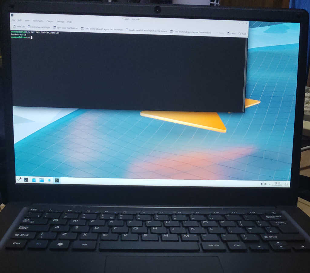

I now also have this working on the pinebook pro! Here are some rough notes:
**WARNING** Not guaranteed to work! There's the possibility I've forgotten a step here btw, not sure!
- You need the files firmware.pinebook-pro-rk3399.img.gz and partition.img.gz - zcat them together as above then dd.
- You'll need 2 micro sd cards - one for an actual debian install and one for the installer.
- a USB to ethernet adapter (makes things easier).
First use the microsd card that you used dd on. Install debian onto that same microsd card (the one with the installer on). It does actually work -- in the installer choose manual partitioning and choose "MMC/SD card"; mine showed up as "MMC/SD card #2 (mmcblk1) 8GB SD". Don't use the 62.5 GB MMC/SD card (that is the internal emmc!).
Make the partition on the microsd card itself (leave the partition that is already on it alone) there should be some space. Create the new partition, set the mount point to /, format type ext4 and bootable to on. Write that and install as normal to the microsd.
Once the install is complete boot off the microsd card. Then install u-boot-menu and u-boot-rockchip.
Then
$ cd /usr/lib/u-boot/pinebook-pro-rk3399
$ cp * /
$ u-boot-update
$ u-boot-install-rockchip /dev/mmcblk2
Then use fdisk and delete (on /dev/mmcblk2) any partitions on the internal emmc. Create an ext4 partition but start it at 32768 as above.
Now use the other microsd card and install the debian installer again (on another linux pc). But this time install to the partition you made on the emmc. Make it bootable and ext4 but do not change it in any other way. Install as normal.
Once complete, remove the microsd then power cycle the pinebook pro. Hopefully it should start up and boot ok. If it won't boot off the emmc, try booting off the first micro sd card again the one with debian installed (with debian installed now onto the internal emmc, mmcblk2) and try installing u-boot again (above). I forget if I had to do this a second time!

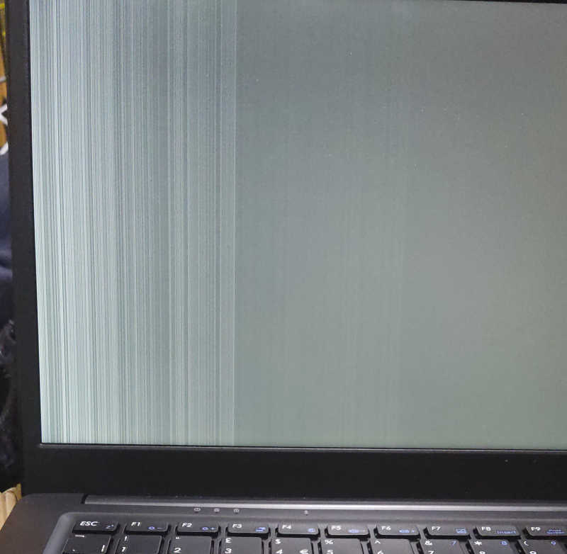

Unknown: Unless it is just my pinebook pro sometimes I found when booting I got lots of grey or white vertical lines and no text. This seems to require powering down, waiting for a few seconds and then powering back on again to fix.
