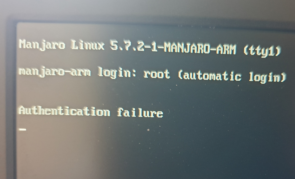

the charging of battery overnight didnt work, and i think it a corrupt MMC, or data on it!
think this it the next step..
Now i first turned the eMMC switch to off, then pressed the powerbutton without SD card.
No response.
then i pressed in the SD card and pressed the powerbutton. now i got a response in the powerled. first red, then green.
but the screen was blank.
next test turn it on with sd card (Manjaro.img) and a USB (Archiso).
then the PBP recognized the Manjaro, but could not install. (Authentication failure.)
Then removed the usb, and restarted with only SD card, but only powerled. and black screen.
The eMMC switch was off all the time.
do i dare turn on the eMMC switch with the PBP on? :O feels wrong....
Edit: after that, the screen stay black, even if i have SD, USB or both. but only when eMMC is off. The screen did only come to live once.
.jpg   feilmelding PBP.jpg (Size: 177.87 KB / Downloads: 670)
