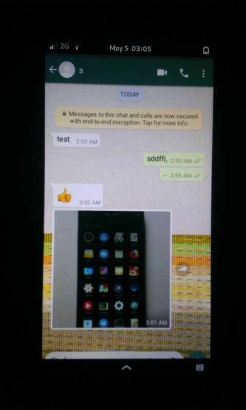

It seems @a-wai has tested Anbox, can you confirm that Anbox is working? And what is the procedure you used?
Thank you in advance.
@a-wai something to consider Smile https://gitlab.com/postmarketOS/pmaports...peed.patch
(05-03-2020, 02:16 PM)chris_02 Wrote: It seems @a-wai has tested Anbox, can you confirm that Anbox is working? And what is the procedure you used?
It probably needs its own thread but here's an earlier post to get you started. It's pretty buggy to say the least - see  photo below. Also needs a kernel update to get internet working.
.jpg   anbox_whatsapp.jpg (Size: 52.31 KB / Downloads: 858)
