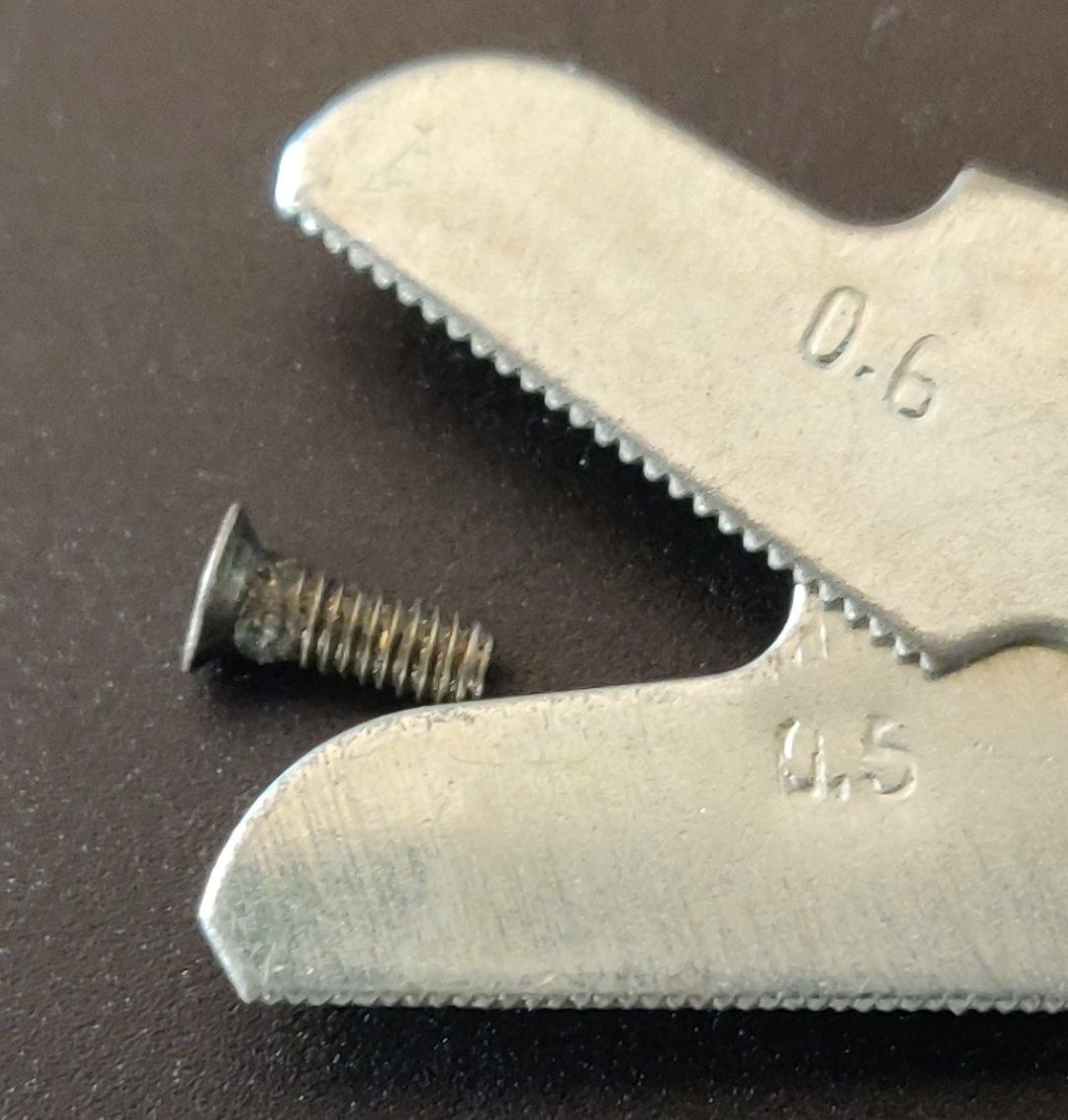

As far as the pitch of the thread goes, it absolutely matters. If you try and put a course thread screw in a fine thread hole, you'll most likely break the plastic.
I broke out the tap and die set for the first time in 15 or so years and pulled out the gauge. When there are this small, it's hard for me to really tell. I'm going to guess from the blown up pic its a 0.6 but could also be a 0.5
.jpg   Screenshot_20200208-142611__01.jpg (Size: 267.52 KB / Downloads: 689)
