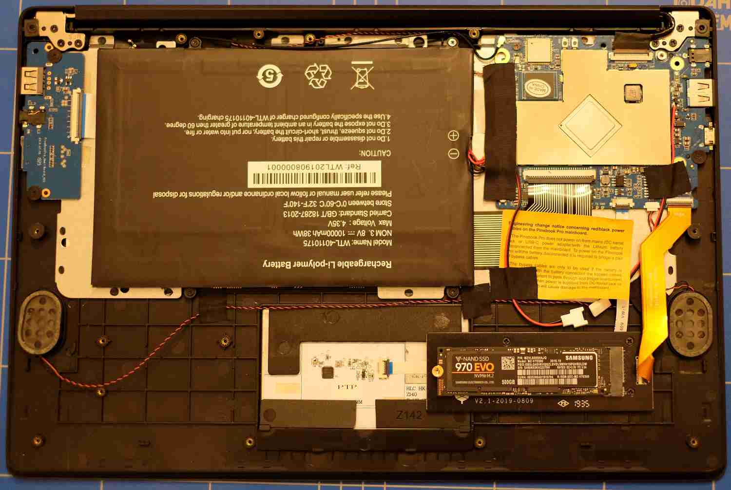

Hello
I got my Pinebook Pro today.
Wondefull little Laptop.
I took first a lock at the build quality. Better then promised. The cover and the Bottom are made out of metall. The middle section with the keyboard is aut of plastic. Very nice lock over all.
.jpg   2_DSF2606.JPG (Size: 87.39 KB / Downloads: 1,917)
Every screw goes into e metall nut so the hole laptop feels quite stiff and solid. Feels equal to my Asus Pro Book.
.jpg   2_DSF2597.JPG (Size: 129.14 KB / Downloads: 1,362)

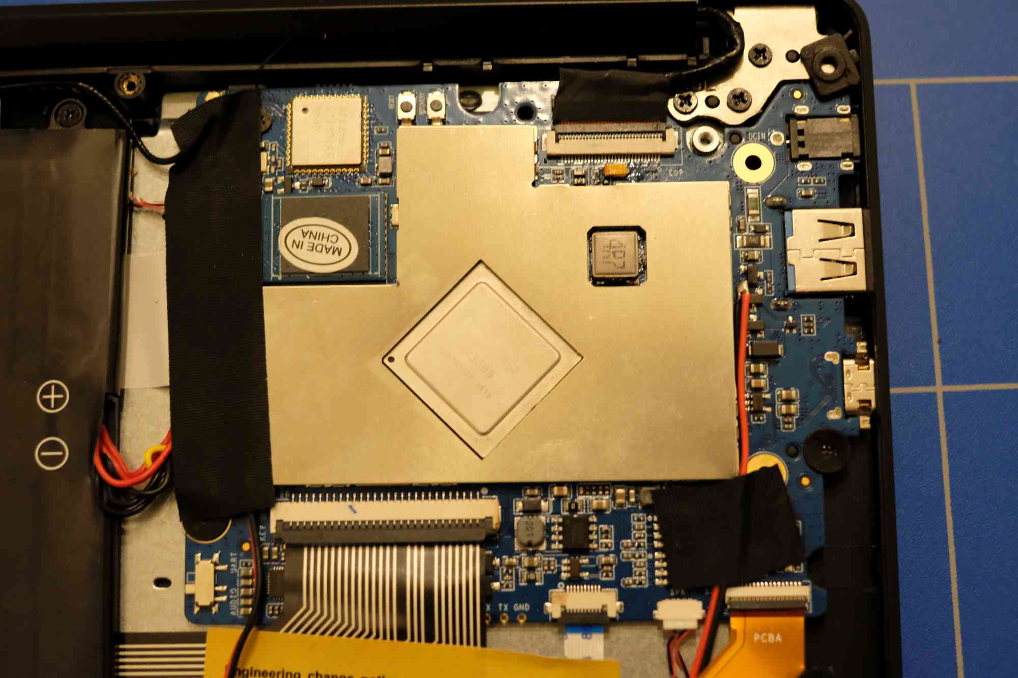

I also locked at the solderjoints at the mainboard and they looked like a charm to.
After testing the Pinebook, mounting the SSD and making some thermal photos, i screwed the bottom back on.

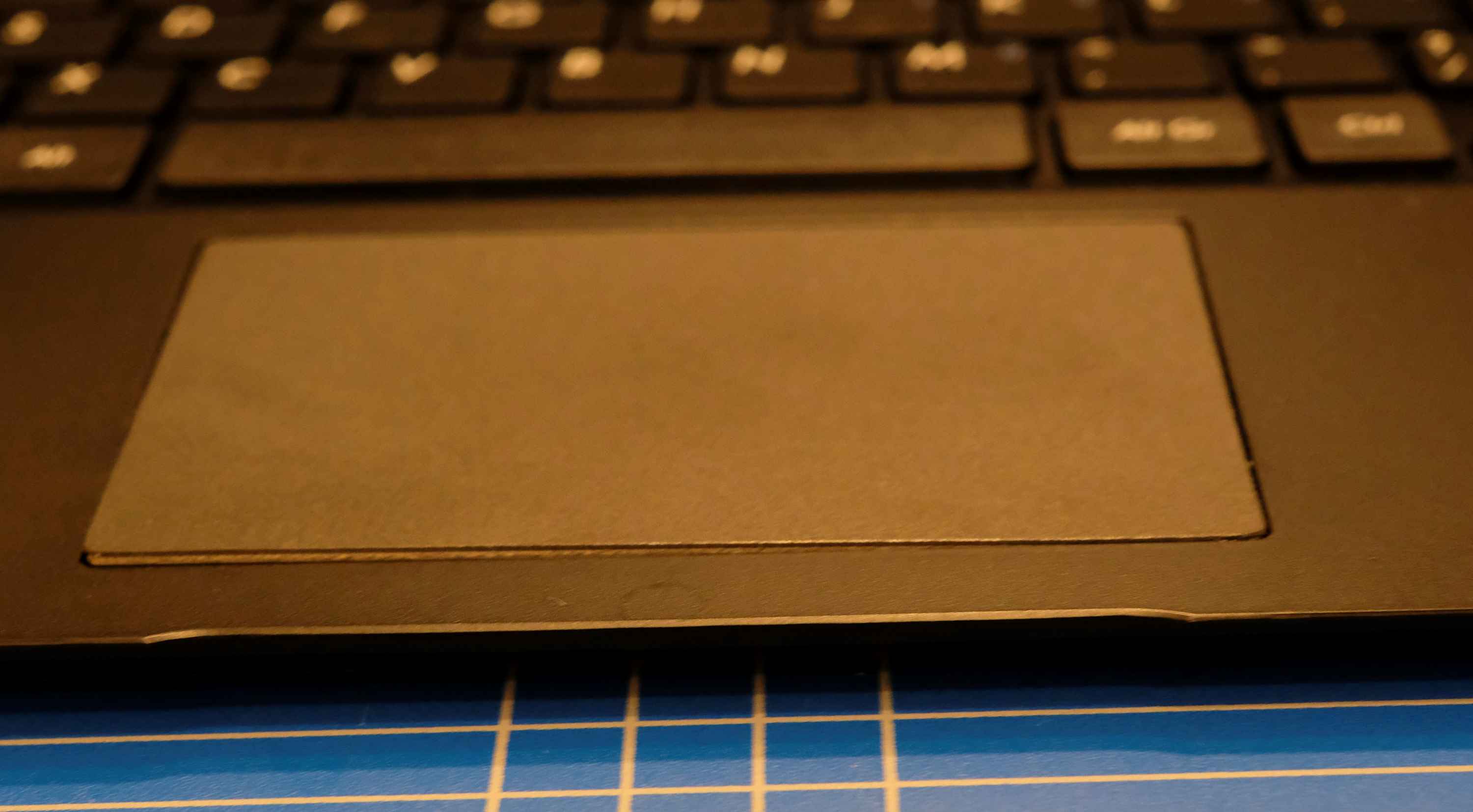

Im not shure if i mountet the SSD right but i noticed a small problem.
.jpg   2_DSF2602.JPG (Size: 150.43 KB / Downloads: 1,401)
The SSD is to thick for the Pinebook so that the touchpad got pressed out of its holder.
Does somone have this problem to?

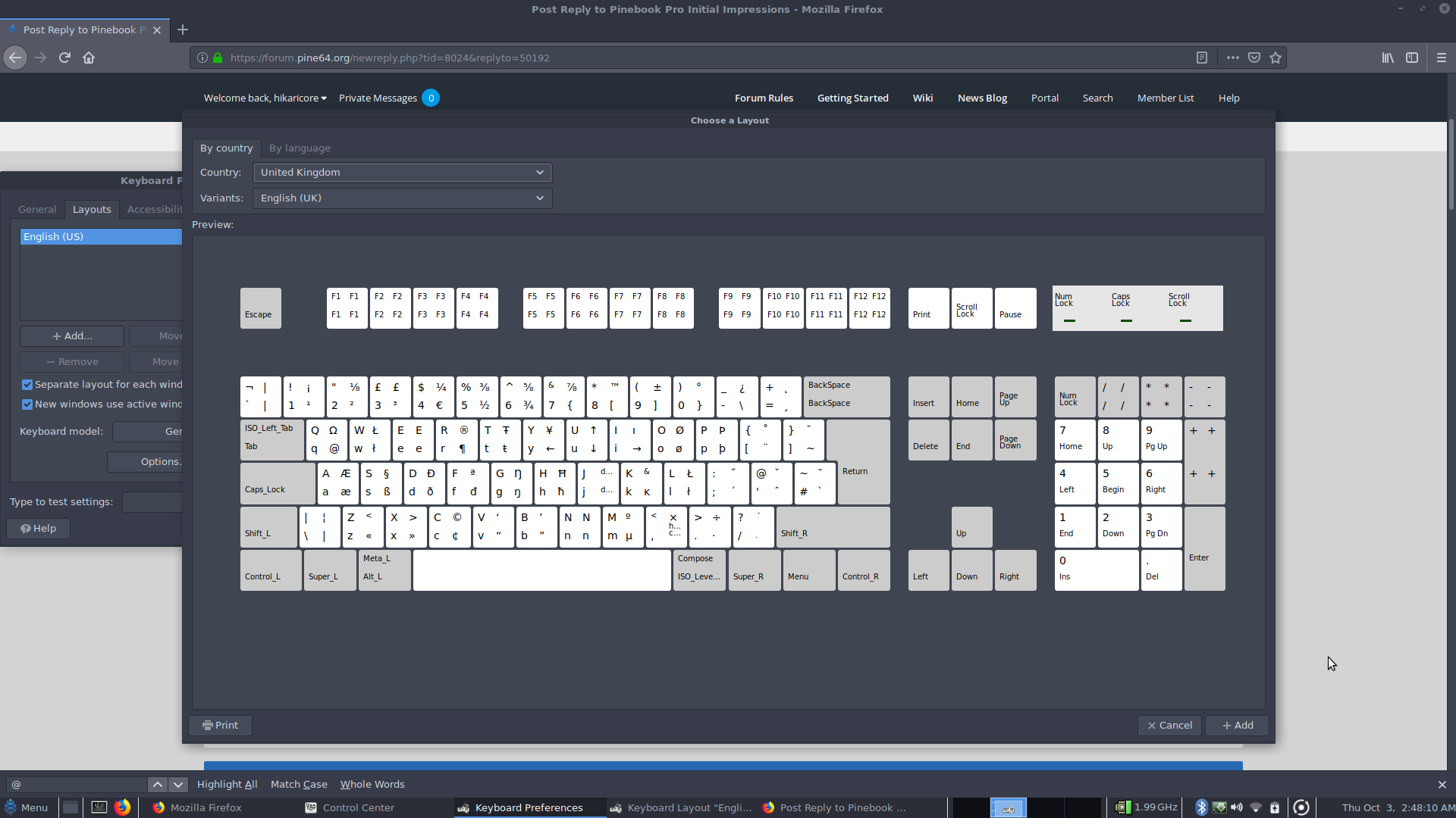

Since the topic came up, you can easily switch to a more comfortable keyboard format to return @ and # to their expected locations.
Control Center > Keyboard > Layouts
By default mine was set to English (UK), so I changed it to English (US) which will give you this:
.png   Screenshot at 2019-10-03 02-47-44.png (Size: 134.98 KB / Downloads: 1,248)

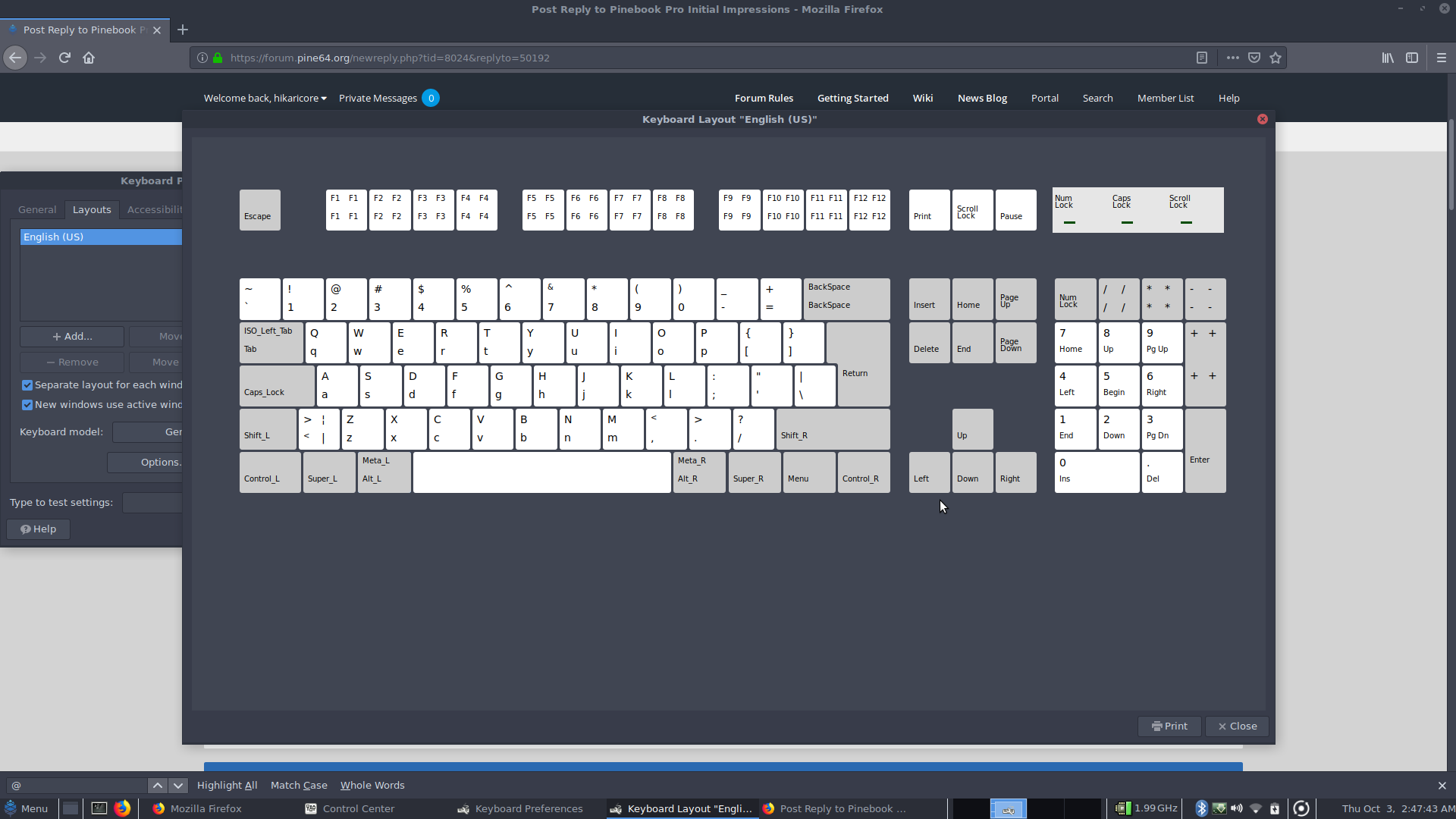

VS this:
.png   Screenshot at 2019-10-03 02-48-10.png (Size: 157.05 KB / Downloads: 1,229)
Obviously you'd need to either change out the keycaps or just ignore them, but it's better than relearning the damn layout compared to what you're used to.   Big Grin

(10-02-2019, 04:07 PM)Omli Wrote: The SSD is to thick for the Pinebook so that the touchpad got pressed out of its holder.
I can confirm there is an issue.  After installing the SSD the left side requires excessive force to activate where as the right only requires a light touch. Although my touchpad doesn't appear to have been pressed out.
