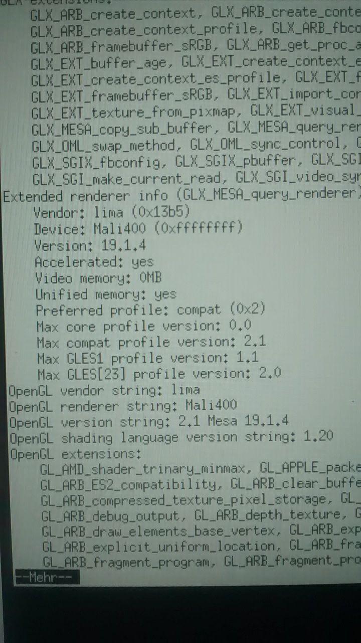

Got 5.2 up and running Smile
Lets check for MESA Driver and DRI Smile
lima drm driver is loaded.
Still waiting for finishing Distribution Upgrade.. to check for mesa drivers.
EDIT: mesa defaults to llvmpipe.
EDIT#2:
Lima Driver is avaible in /usr/lib/dri/lima_dri.so
EDIT#3

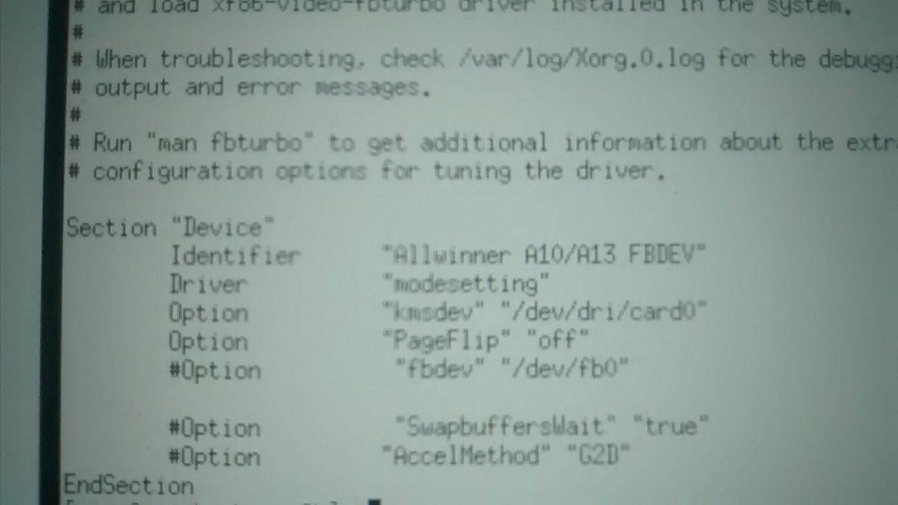

Xorg tells:
FBTURBO(0): no 3d accelration because the driver has compiled without libUMP
EDIT#4:
Forget about FBTURBO - modesetting Driver is required.
Got it working.
Still issues, can`t get glxgears to work properly.
Maybe its misconfigured.
2D Rendering Errors also occur.
sdm login -> black bars and no text.
.jpg   lima.jpg (Size: 131.75 KB / Downloads: 857)
