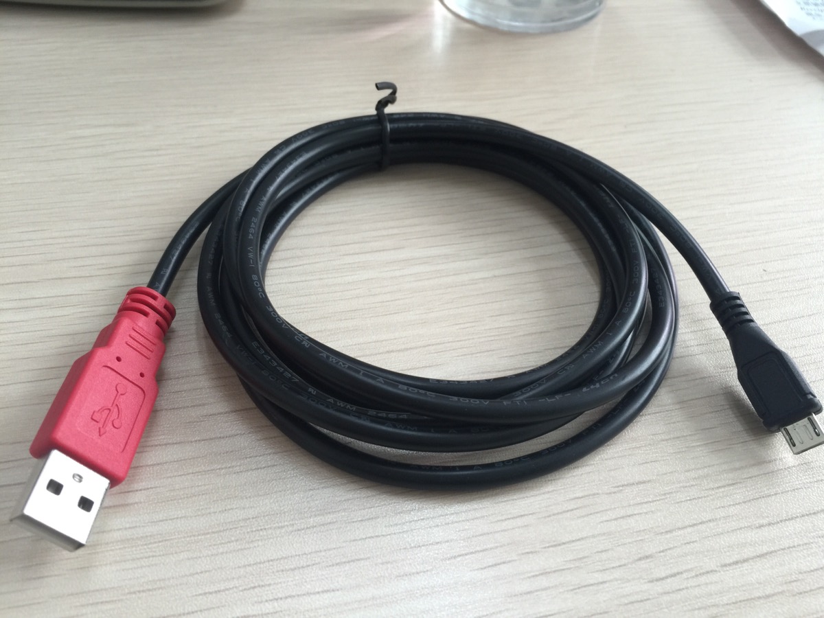

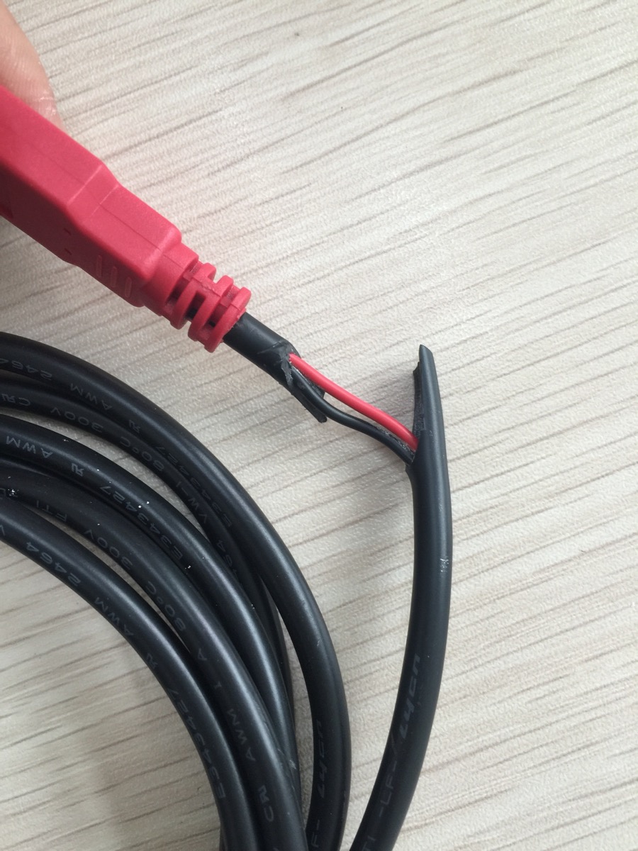

Here are the photo of USB type A to micro-USB power only cable that we recently make. The USB plug is red color indicates this is a "power only cable", there is also a tag (not shown on photo) mentioned power on. We also tear out the cable and make sure our vendor deliver the AWG 20 type.
