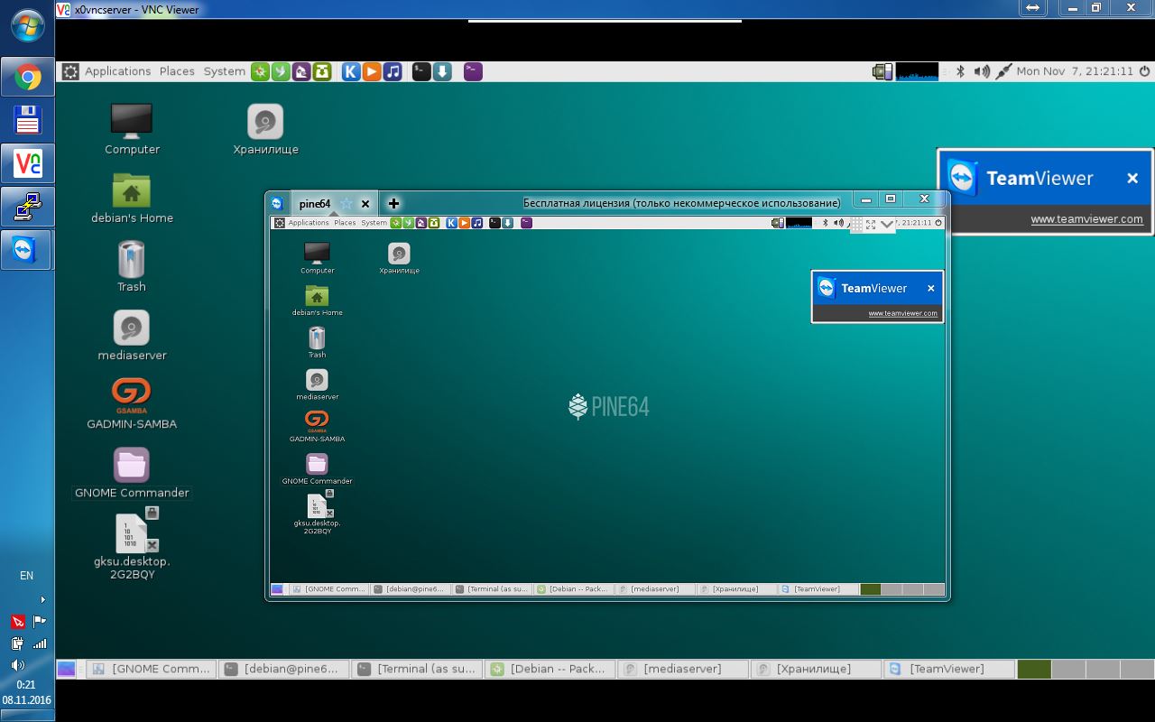

I have done it - TeamViewer-host:armhf on Pine64!  Smile

I don't know... Btw, i cannot make mouse and keyboard input to work in teamviewer due to some differences between Pine and Raspberry... or between Debian and Raspbian. Maybe somebody can help?

(11-12-2016, 09:14 AM)igor Wrote: I don't know... Btw, i cannot make mouse and keyboard input to work in teamviewer due to some differences between Pine and Raspberry... or between Debian and Raspbian. Maybe somebody can help?

Thank you, friend. I have never heared about nomachine and I'll try it.
By the way my teamviewer is finally working. The sollution was found on the ODROID forum:
Quote:Re: How to install Teamviewer
[Image: icon_post_target.gif]by meveric » Sat Dec 17, 2016 5:47 pm
Quote:andimaniac wrote:Are there some news? Have the same issue, I am able to connect but not to control via mouse or keyboard.
It's working fine if you follow the instructions and hints given in the RPi forum: https://www.raspberrypi.org/forums/view ... 3&start=25
The post on top says:
Quote:Teamviewer wrote:Please install the package libxtst6, and everything should just work fine.
I tried Nomachine. It works only in local network. So seems that teamviewer is the only tool for internet remote desktop for Pine.
