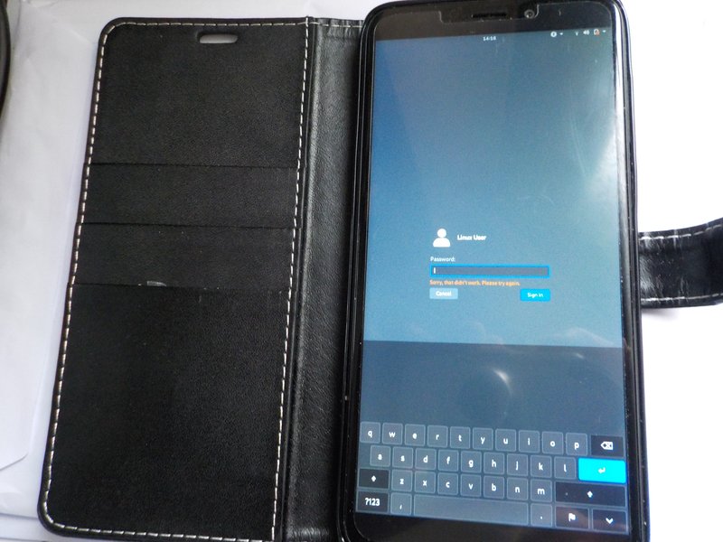

But when I start Gnome with
rc-service gdm start
I get a Gnome login screen with "Linux User" suggested. No password I can think of works (such as "gnome" or "password" etc.). If I click on "Not listed?" and enter "demo" and "147147" or "demo" and "demo", it does not log me in either.
.jpg   DSCN3885.JPG (Size: 80.13 KB / Downloads: 574)
What I like about the login screen is that it makes much better use of the existing space, the status bar is smaller, the keyboard as well. Hope that goes for the whole Gnome experience.
OK, an older version of the Wiki page gave me the clue. I used:
sudo adduser tester
and gave the new user the password "tester". (No need for security yet, we are really just testing).
It worked and I am totally blown away!!!

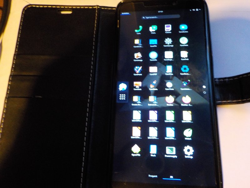

Look at this application screen (these are apps I installed myself before, they do not come with Gnome):
.jpg   DSCN3886.JPG (Size: 71.2 KB / Downloads: 609)

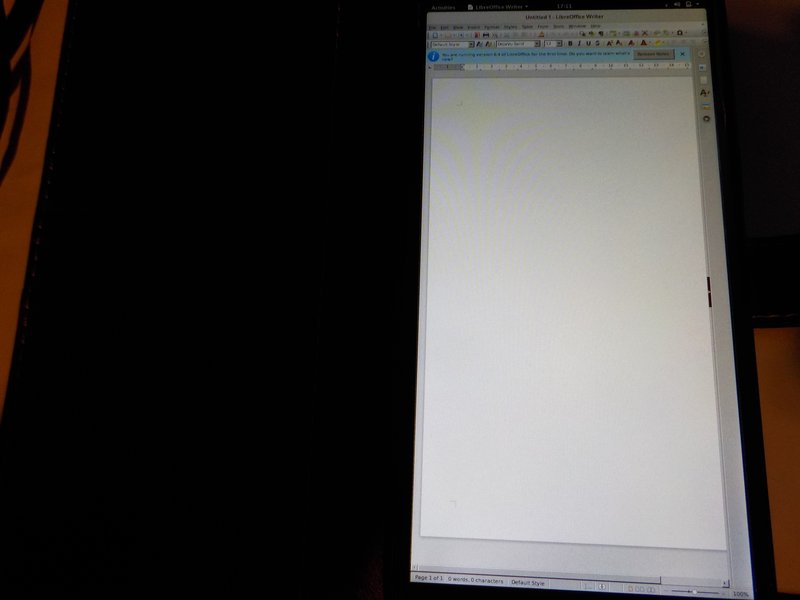

And this is LibreOffice Writer:
.jpg   DSCN3887.JPG (Size: 31.67 KB / Downloads: 593)

What I really like is the navigation under Gnome. In the top left corner, you have a status bar entry called "Activities". This brings up a "Favourites" bar on the left-hand side with your designated favourite apps and also a button that brings up all apps in a grid (similar to a "normal" mobile phone). Otherwise, you can see a minimised view of your open apps.
On the right-hand side, you can have several workspaces, like on a Linux desktop. This is quite handy.
