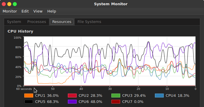

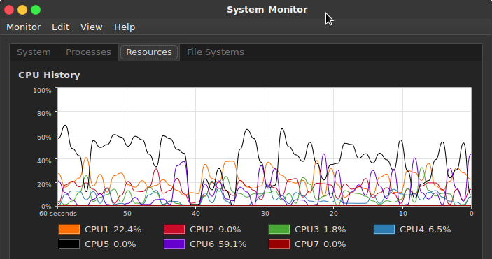

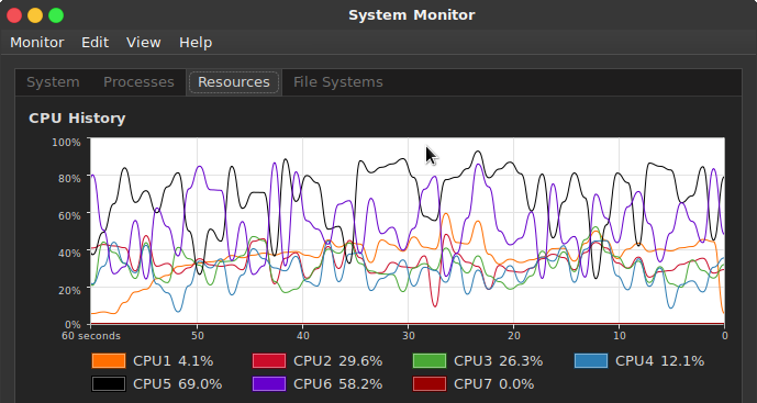

So, these are some (very unscientific) screenshots of CPU usage during system idle, Reaper Playback and Reaper recording. During reaper recording the CPU never went above 1.51GHz. So there is still a bit of headroom. Most of the time the CPU was hovering around the 1.20GHz. I was recording on one track with one microphone.

(01-03-2020, 03:21 PM)Twix166 Wrote: So, these are some (very unscientific) screenshots of CPU usage during system idle, Reaper Playback and Reaper recording. During reaper recording the CPU never went above 1.51GHz. So there is still a bit of headroom. Most of the time the CPU was hovering around the 1.20GHz. I was recording on one track with one microphone.
