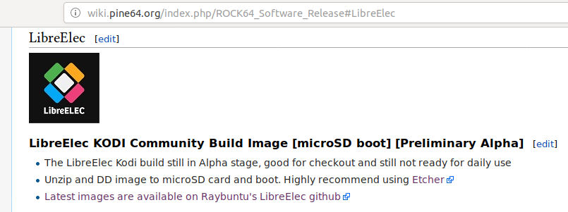

I followed the link to the github page and downloaded libreELEC.tv-archived-re-leia24.zip file. (it was top of the list with the most recent date but there sre no instructions at all on github for noobs)

Thats not an IMAGE its just the SOURCE (as it says Source code (zip)) so you CANT Flash this on the SD card.
For the LibreELEC images use one of this links:
http://test.libreelec.tv/
http://kwiboo.libreelec.tv/test/

Thanks very much. It seems the Pine64 website is linking noobs to the wrong place.

Thanks for that gigagames. Means the wiki needs to be updated, as the below is not correct then.
(06-10-2018, 02:33 AM)Frogmella Wrote: Do I need the .tar file as well as the .img.gz?
Unlikely, it's probably the same image just compressed two different ways... I would think you only need the img.gz file.
I'm just updating that wiki entry now since it's obviously wrong or out of date.
