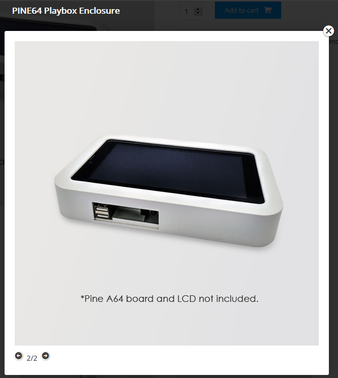

Does the LCD display struggle with this issue as well? I ask because I don't have money right now for a new monitor, but I could afford the display with the playbox enclosure. Howecer, it's a shame I can already tell by the photo, that the enclosure is low quality Chinese made and doesn't fit correctly, otherwise there wouldn't be that open space, especially when one is looking for an enclosure. I hope technology like this gets built in America instead of feeding the Chinese.[Image: ?product=pine64-playbox-enclosure] It's image 2/2.
