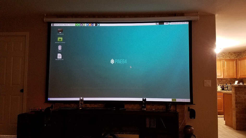

My primary home computer is an Asus Gaming Laptop, and I didn't have a full HD 1080p monitor lying around, BUT, I do have an Epson full HD Projector.
After running out of options, I plugged the Pine A64 into my Projector, and Bingo! That was the issue. It fired right up and within less than 30 seconds, I was
looking at the Debian Login screen. As I type this, I'm about to change the resolution on the Pine to 1680x1050, shut it down and then see if it'll fire up

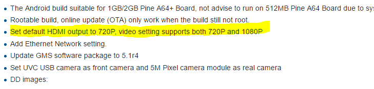

So the issue is the supported resolutions of monitors. On Epson Home Cinema 8350, when the Pine64 booted up with Debian, it was at 720p.
There are only a few resolutions supported at the moment. My monitor's resolution limitations seemed to be the issue.
On my Theater Projector, it works perfectly, which is fortunate, as that's what I want it for... to replace the huge tower I've been using! Wink
Bottom line, and simply... If your Pine64 doesn't seem to do anything other than the Red LED, try it on another monitor!!!
