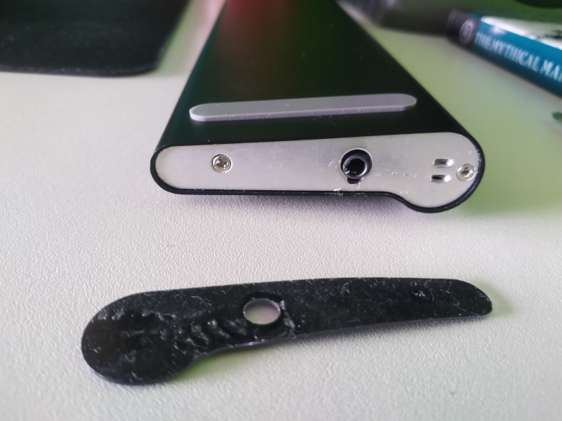

I've also had the same issue (microSD card disappeared), and I want to thank @gritibaenz for this thread!
I want to add that there is non-destructive way to open the case, just heat the black cover (I've used my wife's hair dryer, no special hot air gun is needed) and pry it after the glue melts:
Then the housing can be opened.
It was a little bit weird that the two screws are different sizes, but anyway. Everything works after the reassembly.
