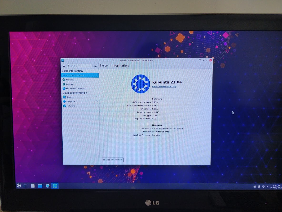

Thanks! Can you please point me to the image you have used? I have no problem using minimal release and then install everything necessary.
I tried this but it does not boot either.
https://redirect.armbian.com/region/EU/r...al_current
I also tried all the images from this forum https://forum.armbian.com/topic/8082-arm...ox-rk3328/ from this repo https://disk.yandex.com/d/DSO6euzB3ahemo and nothing boots. No output on TV, no LED blinking. I changed the DTB config line to Rockbox.
SD card is OK, it boots Libreelec.
I was successfull installing this build from @Mrfixit2001 , but not the latest version, cause it crashes on installing network-manager.
https://github.com/mrfixit2001/debian_bu...xit.img.xz
I replaced the sources.list with Ubuntu 21.04 repo (hirsute) and did full upgrade. It works, so now trying some KDE Plasma and other software.
Wifi works too.
Kubuntu on Rockbox
