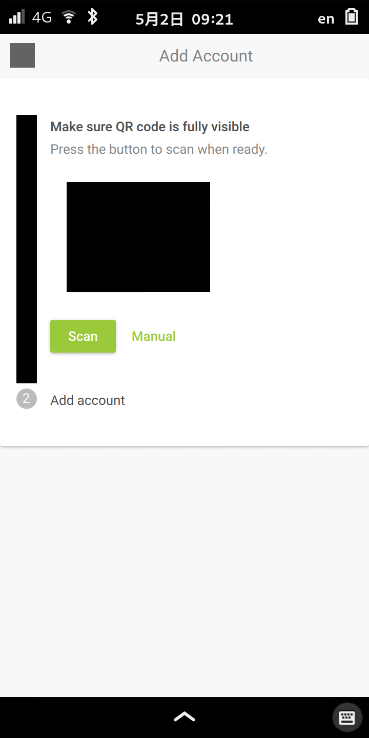

Learned something new today! I installed yubioath-desktop, and so far on the setup screen it looks like it's drawing itself correctly on the mobile screen, lots of empty space though.  It properly detected my Yubikey 5ci as well:
Now to figure out how to use this.. Smile
Nice! Looks promising. You made the blocks black right to masquerade? Or are these some artifacts in the app?
Just read a thread on this forum about delamminating screens.....I'm in doubt. But good the sofware part seems to be doable for me.
(05-02-2021, 07:23 AM)p121458 Wrote: Nice! Looks promising. You made the blocks black right to masquerade? Or are these some artifacts in the app?
I did not retouch the image in any way, the screenshot is exactly how it looked on my screen, so yes, it's not perfectly fitting the Pinephone/mobile form factor...  But it fit way better than I expected, probably owing to the app using QML and modern QT libs.

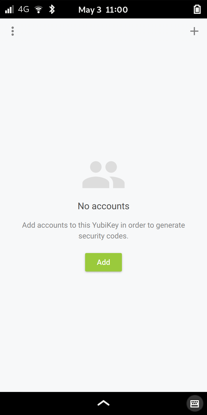

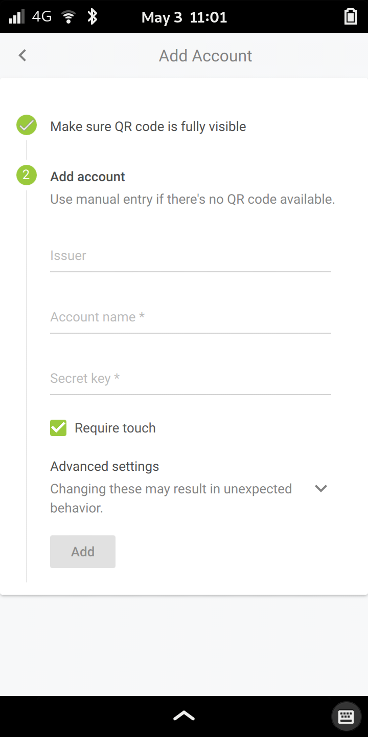

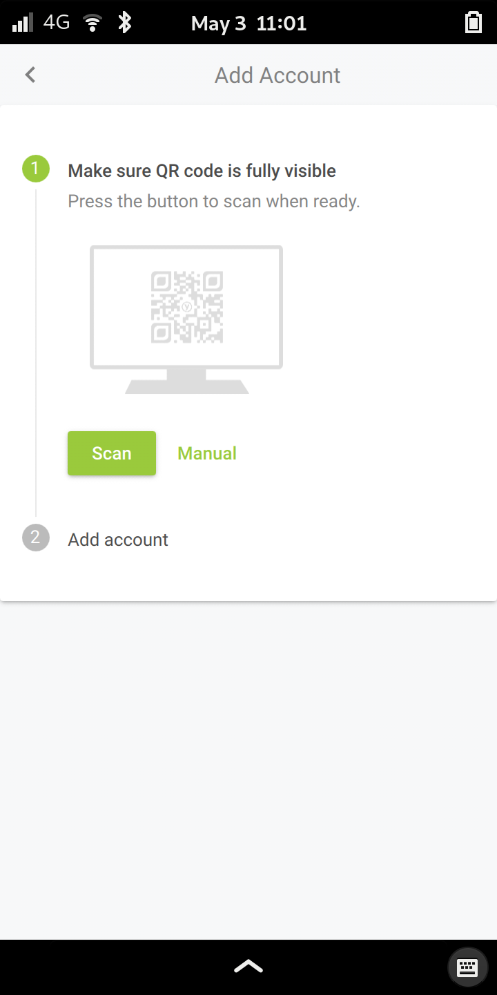

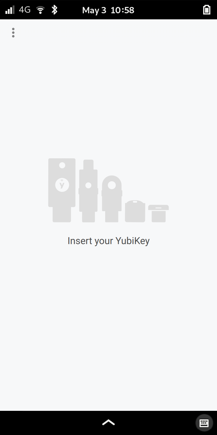

I tried installing the yubioath-desktop package on my Mobian Pinephone, and I do not have the black blocks in your screenshot.
I am attaching unmodified screenshots, one before I plugged my Yubikey into the hub, one right after, then two showing the options for adding an account (scan v. manual).
