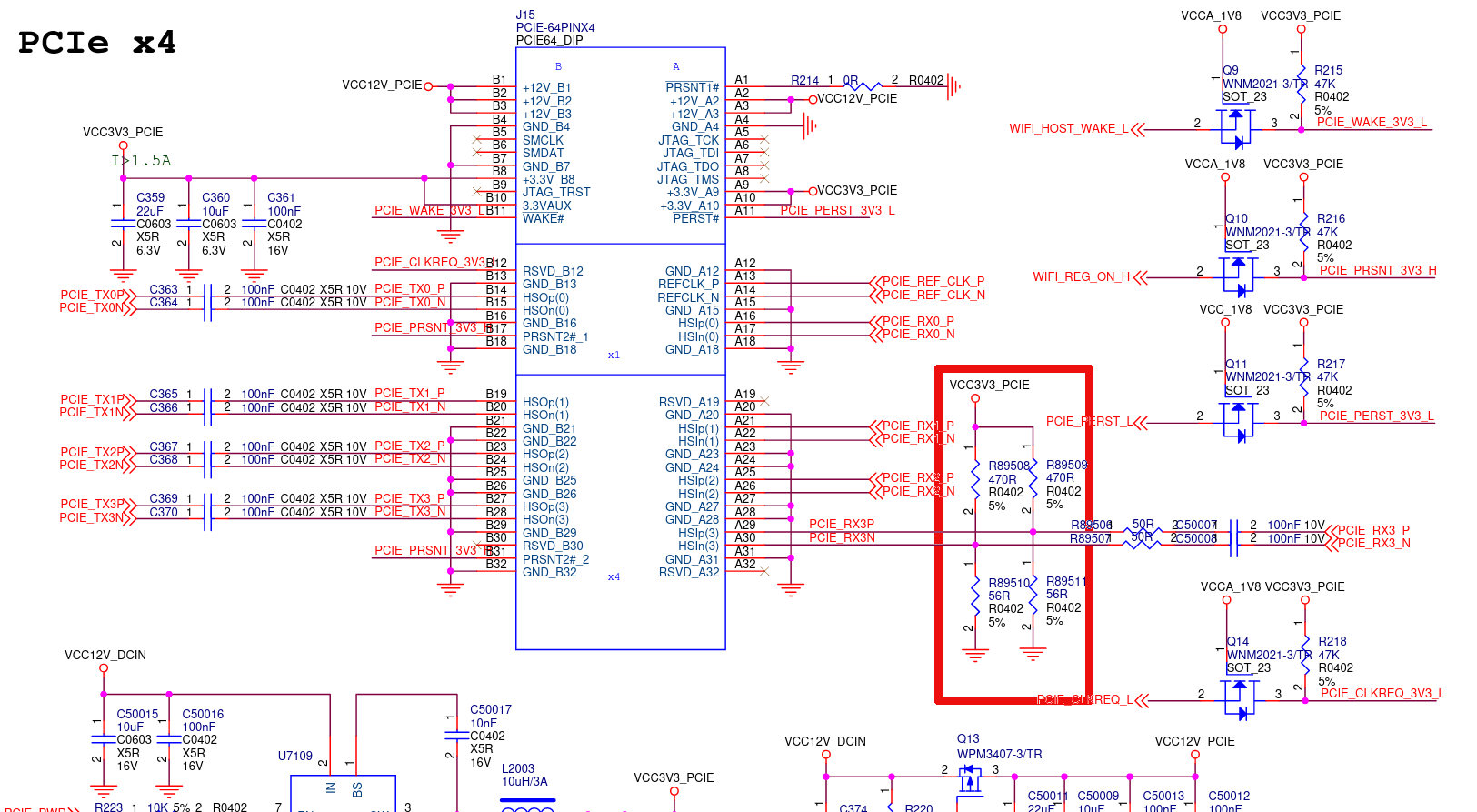

(04-22-2020, 08:56 AM)kuleszdl Wrote: My board is v2.1 2018-07-02 and it does NOT have the mentioned capacitors. I am not sure about the jumpers you mentioned but I don't see any wires there. Would it make sense to add them?
My RockPro64 v2.1, with "2018-07-02" (revision date) and "4719" (production week and date) silkscreened on the PCB, came with the 2x2 block of resistors unpopulated, while the 2x2 block of capacitors and resistors is populated.  This just confirms that the RockPro64 circuit diagrams available on the Pine64 wiki are outdated.
@tllim and @Luke, could we, please, get the updated circuit diagrams?
#27
RockPro64 v2.1 is the latest one and schematic already posted at wiki site.
https://files.pine64.org/doc/rockpro64/r...21-SCH.pdf
#28
(12-23-2020, 05:18 PM)tllim Wrote:
(12-17-2020, 10:01 AM)dsimic Wrote: My RockPro64 v2.1, with "2018-07-02" (revision date) and "4719" (production week and date) silkscreened on the PCB, came with the 2x2 block of resistors unpopulated, while the 2x2 block of capacitors and resistors is populated.  This just confirms that the RockPro64 circuit diagrams available on the Pine64 wiki are outdated.
@tllim: Unfortunately, the PDF file you linked above seems to be outdated.  Please, have a look at the attached image, which is a screenshot of the page 27; for example, resistors R89508, R89509, R89510 and R89511 are not present on my RockPro64 v2.1 board.  This clearly shows that the currently available schematic is outdated.
Could you, please, ask the hardware engineers for the updated RockPro64 v2.1 schematic?
