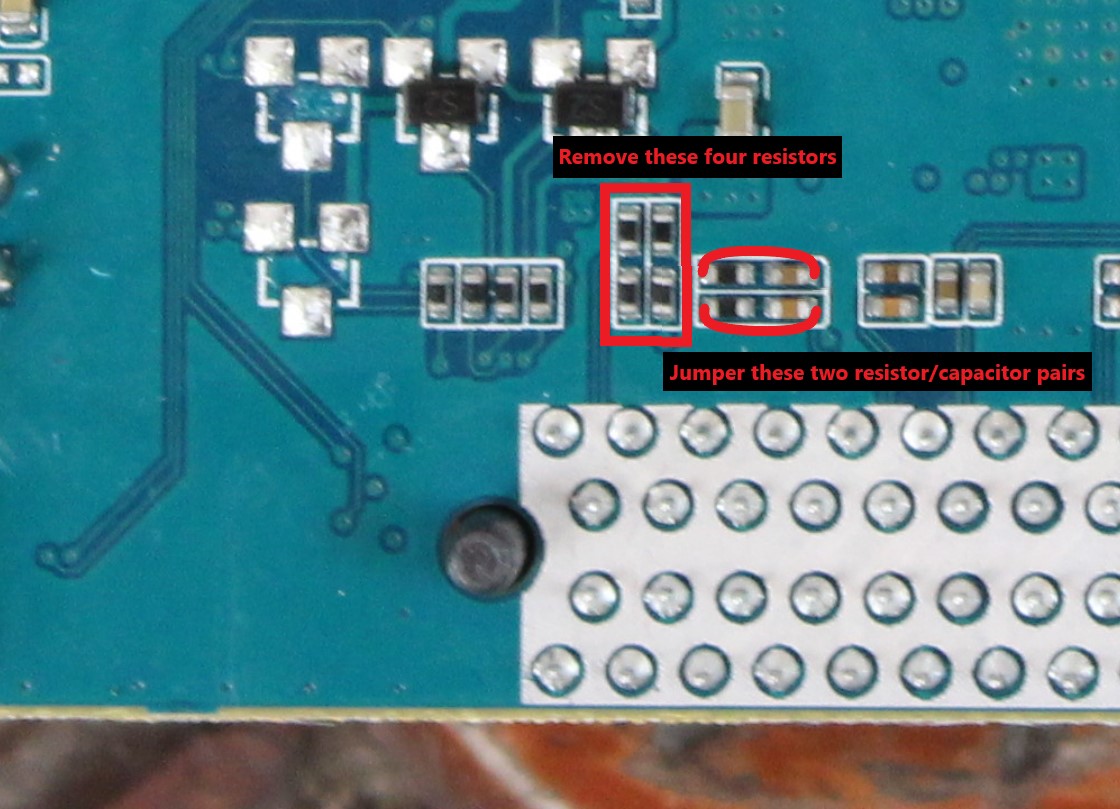

I've just conducted surgery on my rockpro64 and did the following:
Removed R89508, R89509, R89510, and R89511.
Jumpered across R89506 and C50007.
This effectively makes RX3P/N as if they were electrically the same as the other RX data pairs.
PCIe performance is improved with 4x+ cards, and it is more stable.
.jpg   rockpro64-pcie-fix.jpg (Size: 176.6 KB / Downloads: 1,553)
