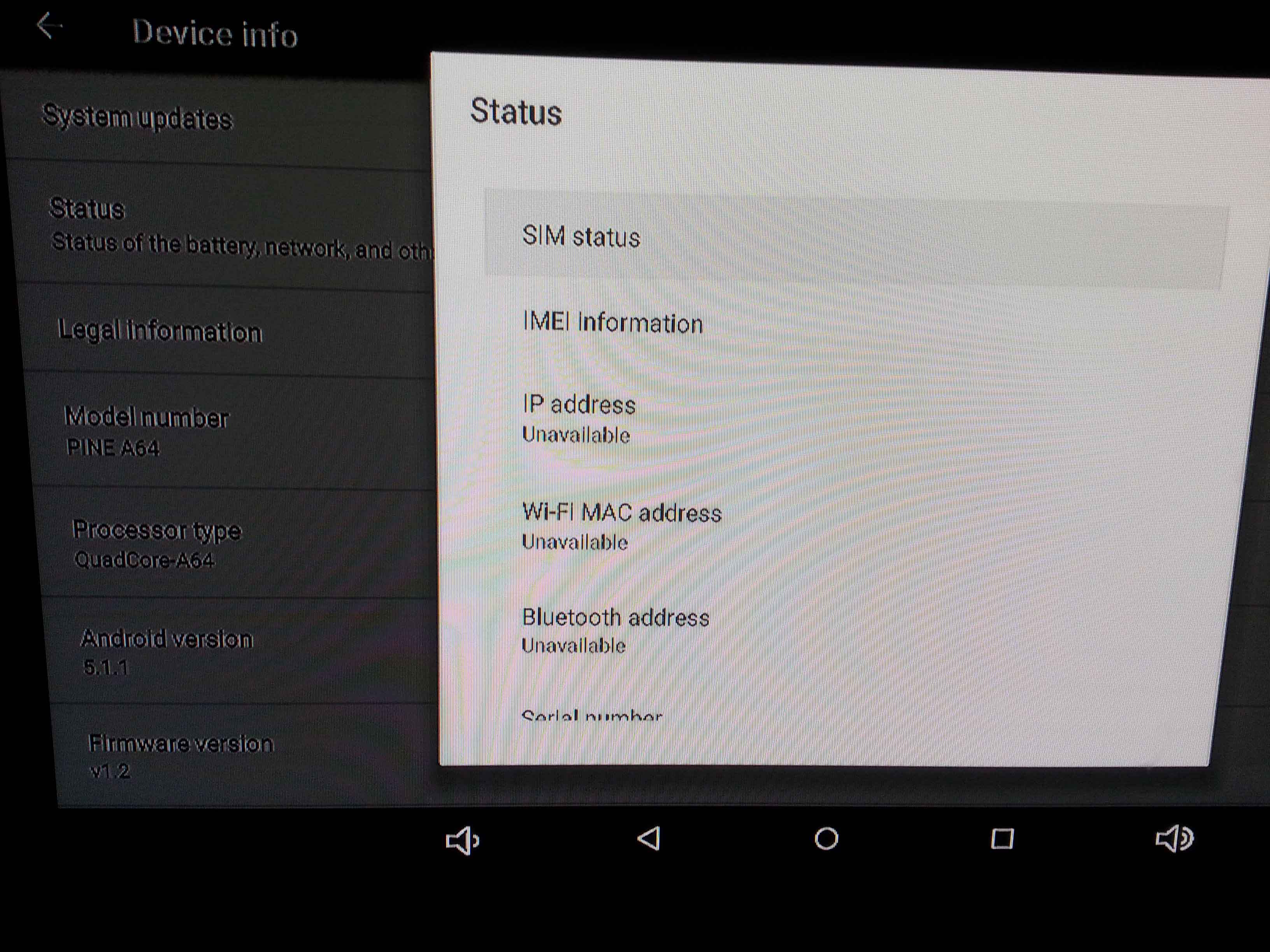

Throwing myself into the conversation.   Running the latest Android image, no Ethernet on 2GB with Gig ethernet.  My network is CAT6 running through Gig ethernet switches all connected to a Microtik router.   Only the Pine64 has issues.  As a side note the latest Arch image has the same problem.
Oh, and Chrome fails to launch.

Funnily enough, the Pine gets an IP, but it's not connecting properly. It's showing in my router now though, but I'm still not able to connect to the internet (TIMEOUT etc). I'll upload some screenies later today.

I just remembered that I had a spare cisco switch lying around, with which I can control network speeds. I set the max to 100mbps, and I got online! This is pretty hilarious imo - I bought the card specifically for gbps (and 2gb ram), and to use the card I have to downgrade my network to 100mbps -_-
