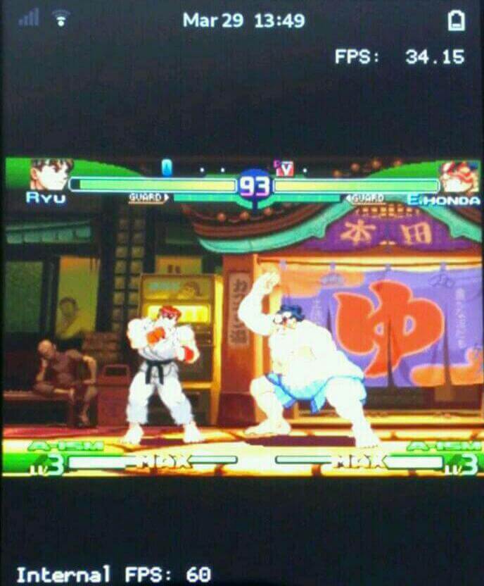

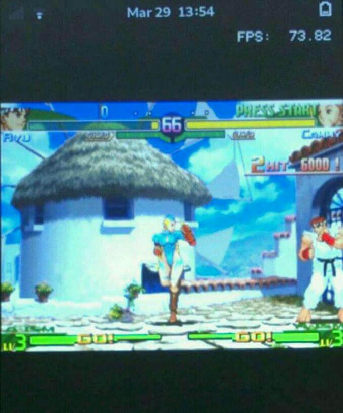

I've been testing out the playstation emulator and notice that disabling vsync doesn't help as much to improve fps for 3d games as compared to 2d games.
For a like-for-like comparison, I ran streetfighter alpha 3 on both mame and pcsx cores on retroarch. I guess there's more overhead on the pcsx emulator but slower paced games are playable.
sfa3 in mame
--vsync--on ~35 fps
--vsync-off  ~70 fps
sfa3 n pcsx
--vsync-on ~25 fps
--vsync-off ~35 fps
.jpg   sfa3_lr-mame2003.jpg (Size: 49.74 KB / Downloads: 947)
.jpg   sfa3_pcsx-rearmed.jpg (Size: 55.71 KB / Downloads: 828)

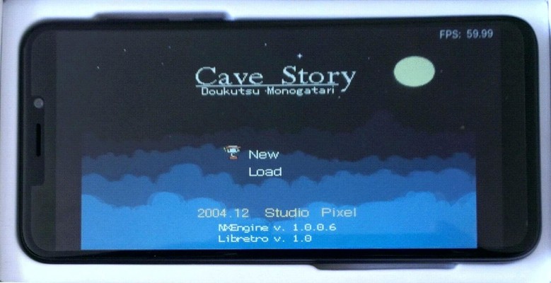

Here's another low res and poorly synced video recording: revenge of the blurrycam. I should really find a better camera but it gives you some idea of the performance to expect.
Edit: Noticed the menu icons were missing so added the assets directory to the retroarch config file
Edit 2: Cave Story works but N64 and Gamecube cores fail to load (egl_bad_match)
