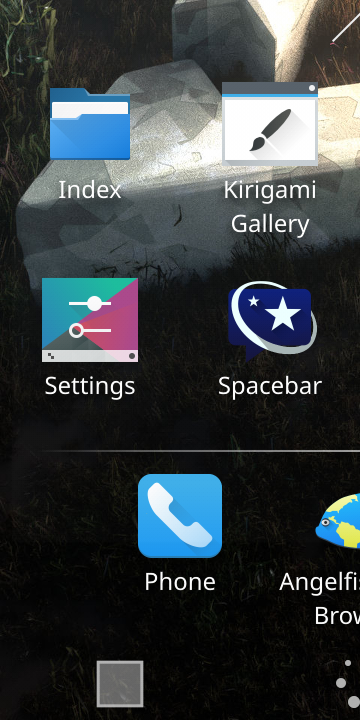

I wanted to attach the screenshots but capturing them via default app resulted into cutting of the screen so their are not usable (see attached example). Also how can I debug further and share the logs with you ?

Screenshots: Plasma Mobile issue, fix is in the works upstream
