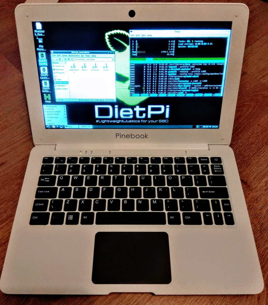

Lightweight justice for your Pinebook A64
http://dietpi.com/download
The DietPi image for Pinebook A64 has the following software installed:
Its aim is to provide the fastest possible desktop experience, using lightweight software and optimisations.
  • LXDE (lightweight desktop)
  • Firefox-esr
  • DietPi lightweight programs to get the most from your system (eg: setup WiFi, tweak process priorities etc):
    dietpi-launcher
Additional info:
  • 172MB RAM usage once booted to desktop
  • OpenGL ES supported
  • Kernel = 4.19
