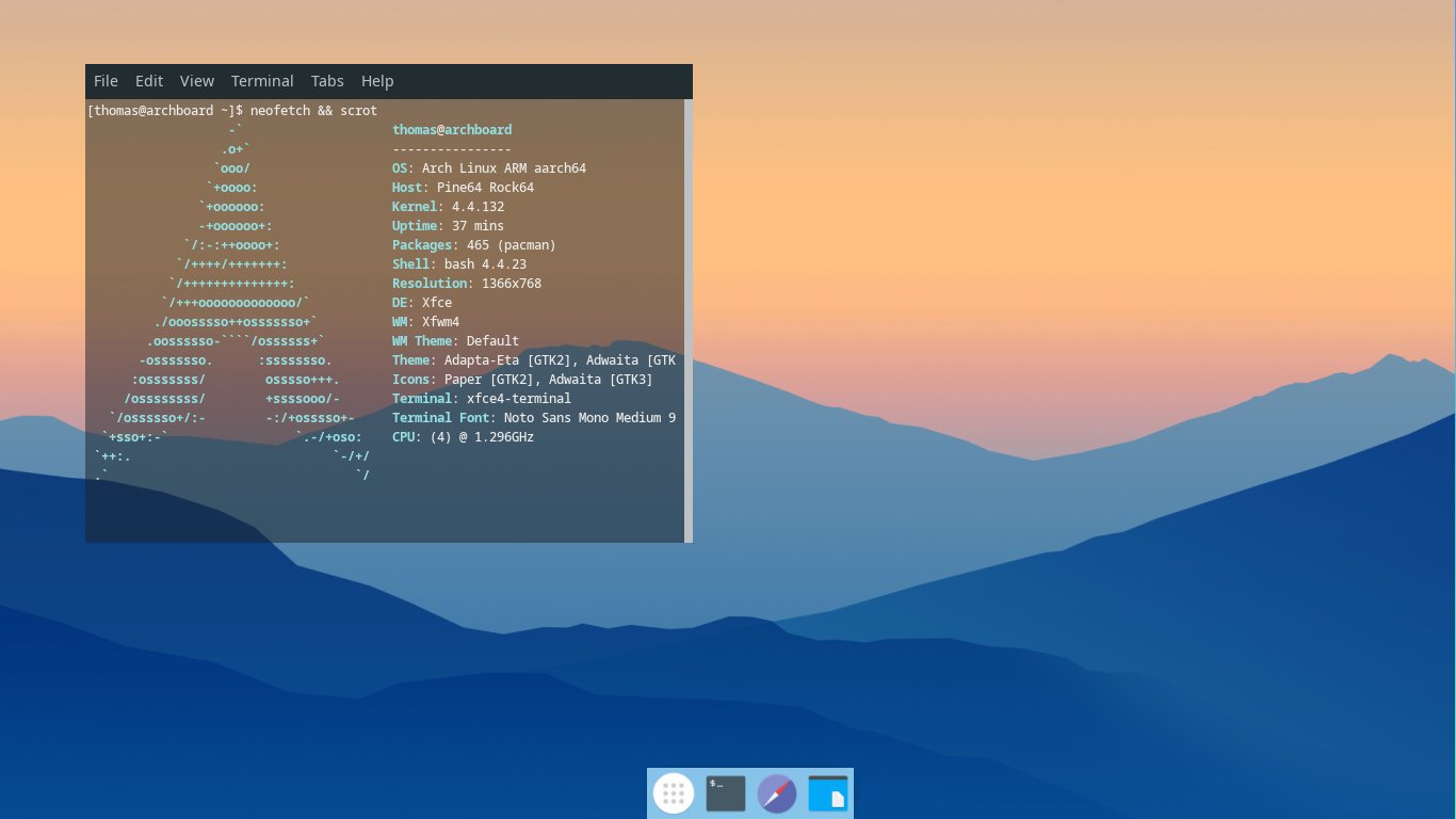

I just burned Ayufans latest Debian Stretch image to my SD card and then deleted everything on / except /boot. After that I extracted everything but the boot folder from the Arch Linux ARM file onto / on the SD card.
I don't have to say, my surprise was huge as this image suddenly booted on my RockPro64. After doing an initialisation of pacman and a first package update, I noticed that Arch Linux suggested to update my kernel from 4.4 to 4.17. I thought this will happen as Ayufans Stretch images incorporate the rockchip custom 4.4 kernel. Anyways I hit the update. To my fortune the stock Arch Linux kernel is called "Image" with "initramfs-linux.img" as the init system, so instead of overwriting Ayufans kernel it just packed the stock one next to it. Then I only had to add an other entry to /boot/extlinux/extlinux.conf before the entries of Ayufan to use the stock kernel and now my RockPro64 is running vanilla Arch Linux ARM!
However, this is only a first test and proof-of-concept, so there are some drawbacks:
u-boot will never be upgraded in this constellation as arch linux simply does not know that there is u-boot installed on the system and there is also no package in the sources that it could use for an upgrade. Also, I did not get my HDMI monitor to work yet (but as I plan to use my RockPro as a headless server I don't care about that very much). I will also have to look to get PCIe working form my SATA card.
But still, I have a vanilla Arch Linux running on my machine.  I know, it was a very dirty way of getting it to run, but I will need to read more in the rockchip wiki on compiling linux and creating images to finally get this to work the traditional way... Is there anyone with interest to port Arch Linux to the RockPro with a little experience in linux and u-boot and image creation?
