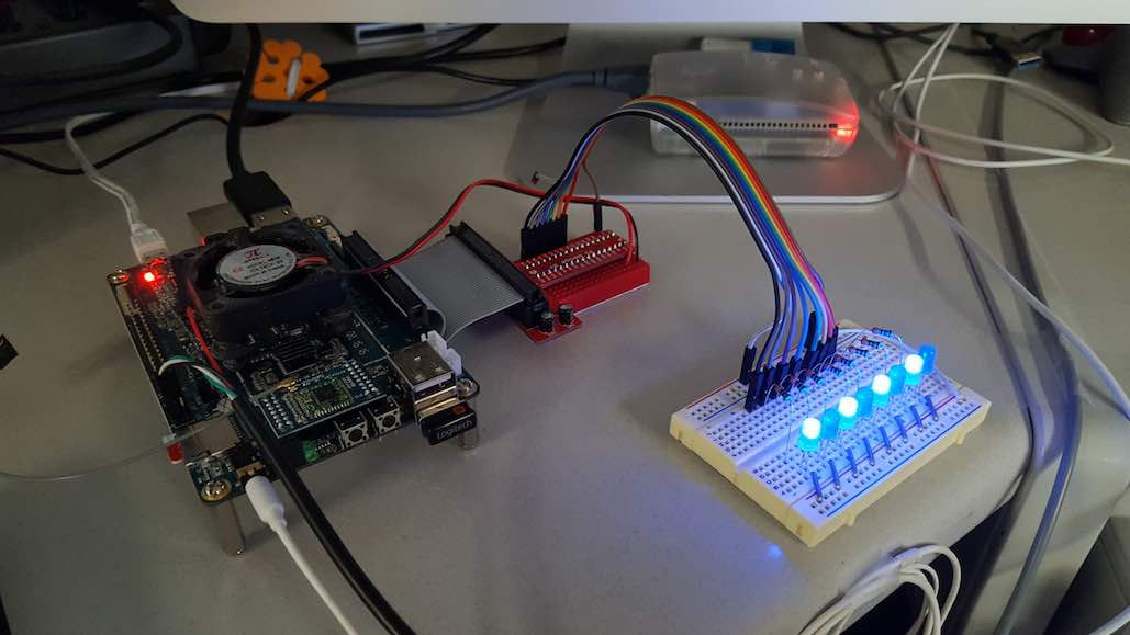

I have reworked my LED lab specifically for the PineA64 board demo codes (uploaded here) which highlight the RPi.GPIO-PineA64 module from github; as well the Sparkfun T cobbler breakout board and 40pin ribbon cable.
The LED layout is changed to a row of blue 5mm diodes in a single line; the GPIO pins are GP20 - GP27 (BCM Broadcom numbering) on the PI bus.

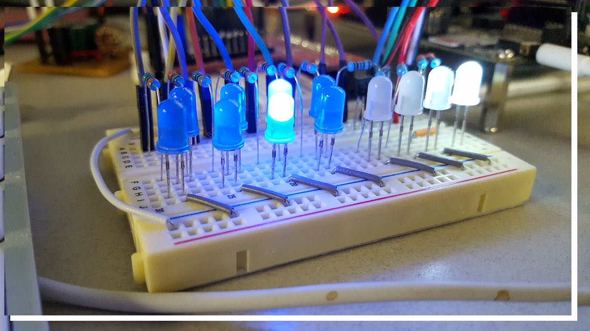

The above pic is an updated photo of the LED lab ;  the white 4bit bus is coming from the euler bus, the blue 8bit bus is coming from the PI bus in a two row configuration.
Each pair of blue LED(s) has a common cathode;  the resistors drive the anodes across the bread board divide where they meet up with the 8bit bus from the PI-bus.
The LED(s) patterns have a different visual effect arranged in two rows of four, rather than a single row of eight(8).
