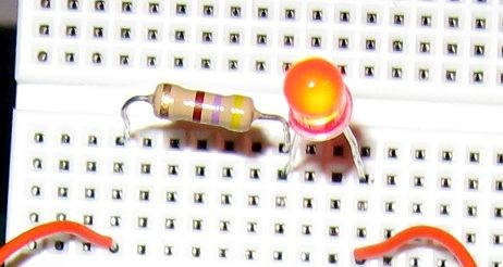

The second option is the easier one. You need an LED and a resistor (anything between 220ohm to 1K will do), a breadboard and some connector wires. If you don't have some handy, I strongly recommend you get yourself a set of male to male, male to female, and female to female dupont connector breadboard wires.... you can get a set of 120 for a couple of $$ on eBay, and you'll find them indispensable in future electronics projects. Wire up the breadboard something like the below example. You then connect the end of the resistor (wire on the left side) to a GND pin on the pine64 (pin 39 will do just nicely). For this example, connect the LED positive (wire on the right side) to pin 40 of the pine64. Now you have the LED connected, ready to make it blink.

sudo -i echo "75" > /sys/class/gpio/export echo "out" > /sys/class/gpio/gpio75/direction echo 1 > /sys/class/gpio/gpio75/value echo 0 > /sys/class/gpio/gpio75/value

Line 2 is where the magic starts. Before we can use a pin, we need to make sure it has been initialised. The only bit you would normally change on this line is the number. If you look at Joey's GPIO pinout reference, you'll see that the reason I specified 75 is because that is the pine64 GPIO port number that corresponds with pin40!
Line 3 tells the pine64 if the GPIO pin is to be an input or an output (the I/O bit in GPIO). Since we want to turn an LED on and off... we want it to be an output. If we had wanted to monitor a swtich or button, we would have specified it to be an "input" instead.
Lines 4 & 5 are the ones that will be the most exciting, and have been what we've been working towards... Line 4 will make the led turn on ("1"), and Line 5 will make the led turn off ("0"). Think of "1" being "POWER!" and "0" being "NO POWER!", as that is essentially what those lines are doing... turning the pin output on and off. You can run those last two lines as many times as you like... , and if the pin is on and you try to turn it on again... unsurprisingly nothing will happen.
