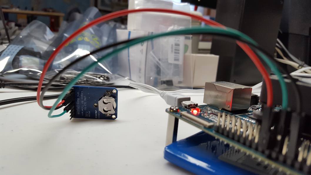

I have been testing the Ada Fruit GPS Ultimate Breakout Board with my PineA64, and have found it to be a very handy device for local GPS, and truly the ultimate breakout board for GPS gurus.
The breakout board is in the mid-ground of the pic above. I have the board connected to uart4 (ttyS4) on the PineA64 board, where I am reading and parsing the NMEA sentences from the GPS receiver using Python (codes submitted and explained below). The pinouts for the euler bus may be found here. I use a four color ribbon from the gps module (red 3v3 Vcc, green Tx, white Rx, black Grnd). The red wire plugs into euler bus pin(17) 3v3, the green wire plugs into pin(21), the whire wire plugs into pin(19), and the black wire plugs into pin(25). It is important to note that the Tx line of the module (green) plugs into the Rx pin on  the euler bus; the Rx line of the module (white) plugs into the Tx pin of the euler bus.  Tx and Rx  cross.  ( in human terms, your mouth speaks to someone's ear, they listen with their ear to your mouth!). Use the pinouts sheet from the wiki to identify and utilize the uart3 if you like. The codes will need to modified slightly should you decide to use uart3.  In the pic below you'll notice that the white wire is missing; that's ok, if you're not going to be sending commands to the gps receiver, and the receiver works very well by default in most cases.
The PineA64 lith-ion batt is in the foreground with the LED lab in the background.  The pic below is the verso of the breakout board showing the backup batt and holder (which may be optionally soldered in place). I strongly recommend the backup batt (and bracket) because it significantly reduces startup and acquire times... the receiver gets smarter over time, and memorizes GPS sat information as it runs.

The breakout board will flash once every second until a fix is established;  thereafter it will flash once every fifteen seconds.

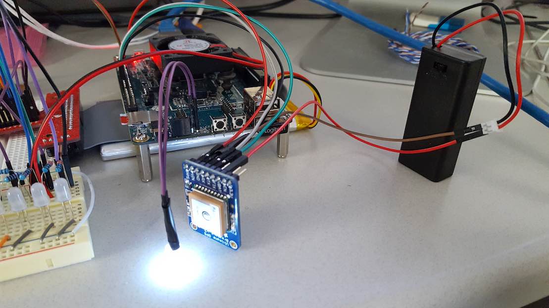

A little research found a way to salvage my $40 dollar mistake.  One of the breakout pins is an input called VBAT. The VBAT pin also connects to the breakout RTC backup battery , and can double for the coin cell clip. Frankly, I wish I had know that in the beginning and I would not have messed around with the coin cell clip to begin with.
I have now chosen to use an AAAx2 battery box (with switch) to backup the RTC and gps settings; this of course saves those really long gps bootup and acquisition times.

Here is a pic of the VBAT installed with the rest of my PineA64 guts.
... the battery box is a AAAx2 with a slide switch. Positive 3v+  goes to VBAT and the negative lead of the battery box goes to ground.  I have soldered the gps ground lead (black) to the VBAT ground lead (brown) because the gps breakout only has one ground pin.
The VBAT is absolutely necessary for real-life practical use of this gps unit... otherwise boot-up and acquisition of fix can take anywhere from 15 minutes to a couple of hours !...  The VBAT holds the Real Time Clock, as well as satellite info for the next bootup... subsequent bootups will take considerably shorter and shorter periods of time as the unit learns;  turn the battery off, and you have to start over !
