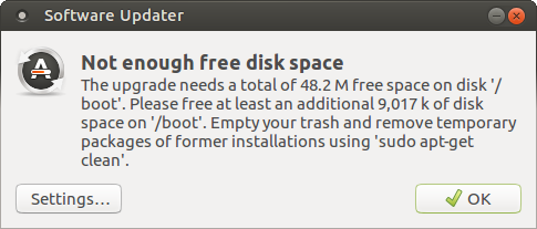

However, I did a check for updates and there are some.
But Ubuntu tells me there isn't enough space on /boot to do the updates.
I've checked the structure of the MicroSD and there is a small unallocated space at the beginning, /boot, which is about 52MB followed by / which takes up the rest of the 32GB space.
Is there a reason why the updates are trying to install to /boot rather than /?

Many thanks for this advice. It worked perfectly.
I was trying to update from the Mate System/Administration/Software Updater menu option, which listed a number of updates. When I clicked 'Install' I got the dialog in the attachment to this post.
I then used 'apt update' and 'apt upgrade' as you advised and all of the updates were installed. I then rebooted and used the System/Administration/Software Updater menu option again and Ubuntu reports that the system is up to date.
I'm happy that the update is done, but as you can see from my attached screenshot, there is an issue about space on /boot.
I'll use the terminal to update in future, but I thought it useful to post the screenshot.

I haven't checked how the images are partitioned lately, but this error is typically due to the boot partition being too small for a kernel update to be installed, as they are normally installed side by side with the currently running kernel, in case there is an issue with a new kernel that prevents your machine from booting. If you have several kernel versions installed, it is possible to clean-up some of the older ones, and gain back space in /boot. This is a pretty common problem on ubuntu also, when you have a multi-partition setup... there are no end of people on the ubuntu forums wondering what is going on, and why Ubuntu doesn't do some self-cleanup every once in a while when updating! :-O
I'd be surprised if this is the case though, unless there has been a change in the last month or two whereby the kernel for the pine64 is now packaged in a repo and checked when running apt-get, instead of via the custom update-kernel and update-uboot shell scripts.

I concur that this happens in the graphical system update for Ubuntu Mate if you go to "System->Administration->Software Updater"   It will give you a message that there is not enough storage left in /BOOT to finish the update.  At no time did I ask it to start in /BOOT.
