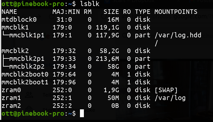

New year again and finally a success. I created a new sdcard with armbian and could boot from it. The eMMC was not visible in the lsblk output.
I opened the case and was looking for eMMC switch when I noticed that the eMMC was loose. I pressed on it until it locked. After that, I could
see it in lsblk. After removing the sdcard, I turned it on and saw the green led, but it wouldn't boot from eMMC. Back with the sdcard, I could mount
the 2 partitions on the eMMC and it looks normal (uboot and linux). For now, I'll be using it with the sdcard and decide later, what to do with the eMMC.
(01-15-2023, 12:29 PM)ottahe Wrote: New year again and finally a success. I created a new sdcard with armbian and could boot from it. The eMMC was not visible in the lsblk output.
You'll need to take the bottom cover off, turn the eMMC switch off, boot with the micro-sd card, then turn the eMMC back on, and re-bind it.  Then you can zero it and put everything back together.
Before taking the bottom cover off, open the lid and leave the monitor half hanging over the edge of a table.  The case is incredibly fragile with the bottom removed.

The boot partition had the dirty bit set, the root partition was ok.
There was no blkid in the extlinux.conf or fstab, only labels. The LABEL=ROOT_MNJRO_MNJRO
was wrong, I changed it to LABEL=ROOT_MNJRO, after that the old Manjaro came up.
LABEL Manjaro ARM
KERNEL /Image
FDT /dtbs/rockchip/rk3399-pinebook-pro.dtb
APPEND initrd=/initramfs-linux.img console=tty1 console=ttyS2,1500000 root=LABEL=ROOT_MNJRO_MNJRO rw rootwait video=eDP-1:1920x1080@60 video=HDMI-A-1:1920x1080@60 bootsplash.bootfile=bootsplash-themes/manjaro/bootsplash
I will replace the Manjaro with something newer. Thanks for the hints.
