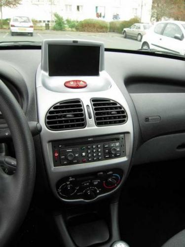

Hello, I'm happy to see this thread, because the original reason I bought the pine64 was to make a android-based CarPC Smile
Here are my plan
*WiFi througt Huawei E5331 3G/Wifi modem
*GPS (Anyone have a VERIFIED GPS receiver that works with Pine64?), to use iCoyote (Waze-like). But the app itself doesn't start.. Too see later. And navigation with Tomtom app
*Pine64 on permanent 12V
*7" screen (who is already installed in the car, waiting for his Pine), on accessory 12V
*Touchscreen? Do you know if these eBay touchscreen module works with Pine?
*Music to my actual car radio (via jack or BT I don't care), to play Spotify.
My screen looks like this! It's an unique thing, as this car isn't made to accept screens, so handmade and looks dope !
[Image: DSCN0276.jpg1..jpg]
I would be glad to help you on this project !
I'm currently waiting for my WiFi Module (Didn't bought it when I bought the Pine so...) and looking for a working GPS module

Hi @ipsw
well we still waiting to get some info about a gps that can work with the pine via usb or seria l
i have posted some of the GPS that might work with it, due their compatibilitu with android
i have also made some research about tp and android seems like some aresistive touch are already compatible with android via USB and maybe that one that u have, can work
i u can test those out o others that u think can work ls post them Smile
BTW: ur screen looks dope Though
