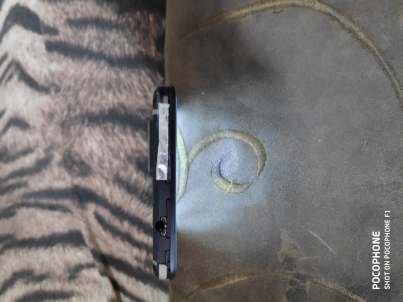

Good Morning
Thank you for your attention and I leave a photo that I hope to be able to add in the post with an addition of aluminum paper on the gps antenna, fixed with transparent adhesive tape to make the photo, which considerably increased the signal level, obtaining a good signal-to-noise ratio. best.
I suggest it be researched to confirm and implemented if possible in the next phones, so I hope I could have contributed to this project in some way.

@Benatti was that trial and error or a calculated size and position of aluminium? From one of the photos I saw recently it appears the GPS antenna has changed between my Brave Heart and whichever later revision was in the picture, which may be a reason some people are having more problems than others with reception. Unfortunately I don't remember where the photo I saw was. Anyone here have experience with antenna design?

(07-06-2021, 07:24 AM)wibble Wrote: @Benatti was that trial and error or a calculated size and position of aluminium? From one of the photos I saw recently it appears the GPS antenna has changed between my Brave Heart and whichever later revision was in the picture, which may be a reason some people are having more problems than others with reception. Unfortunately I don't remember where the photo I saw was. Anyone here have experience with antenna design?
@biketool That might be a handy way to get approximate location when you're out of mobile data range and have iffy sky view or luck with sat locations, but it's not an alternative to AGPS. I know some gps systems can get a quicker fix if you prime them with rough time and location, but I don't think this is one of them - at least I didn't see it in the GNSS AT command docs. The AGPS provides an alternate source of almanac and ephemeris data to receiving it uninterrupted and error free from the satellite signal, which can be a problem with our poor antenna.
It's going to be difficult to explain, because I'm going to write in Portuguese and play it on the translator and then post it, and there are things you need knowledge in electronics to understand.
Due to my knowledge in electronics, the size of the antenna is related to the frequency of the signal to be tuned, which can be tuned by the main frequency or by the harmonic frequencies, and by doubling the size of the antenna, you keep tuning even if it is by the harmonic and double frequency the signal strength at the antenna. Of course, there is a tuning circuit, tuned to the desired frequency, to avoid interference from other signal frequencies.
So, as for the size of the antenna, I already had an idea, and looking at the size of the antenna on the device, you will see that it was approximately the same width and twice the size, adding the antenna of the device with the piece of aluminum paper added, as for her position, it was by trial and error, this being the position that worked best for me.

(07-05-2021, 03:20 PM)Benatti Wrote:
(06-09-2021, 10:21 AM)wibble Wrote: There's some movement on getting assistance data loading into distros.
OpenSuse have this:
https://build.opensuse.org/package/view_...y?expand=1
Dylan Van Assche has been working on Mobian via egs5-manager as well as upstream ModemManager:
https://gitlab.com/mobian1/devices/eg25-...equests/15
https://gitlab.freedesktop.org/mobile-br...issues/357
Good Morning
Have you scratched stock antenna on the phone to get better electrical contact or used some electrically conductive glue? Could you get a better picture of your antenna?

(10-17-2021, 05:47 AM)EuvzO8 Wrote: Have you scratched stock antenna on the phone to get better electrical contact or used some electrically conductive glue? Could you get a better picture of your antenna?
I have done the same modification as Benatti described. Antennas on the phone have conductive surface, so you don't need to scratch. A little bit of pressure has to be applied to get better contacts between aluminum sheet and antenna.
